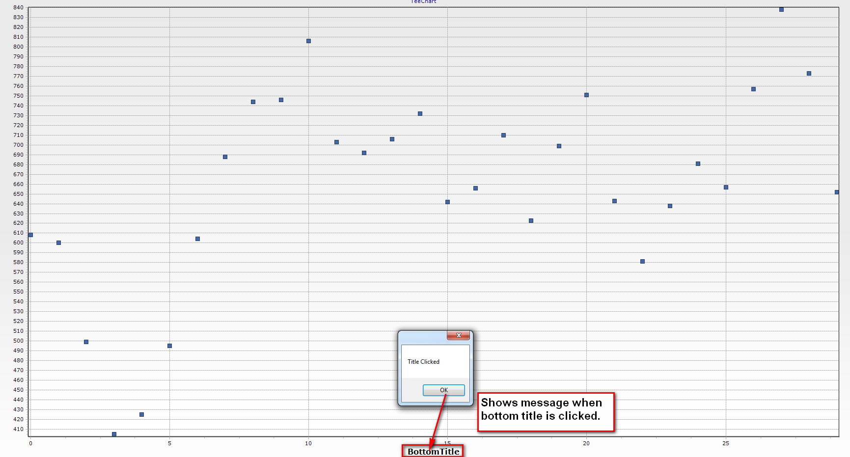

Hi Steema Support,
Is it possible to show message box on clicking Title of the axis. As shown in attached image.
please provide any solution for the same, it is very helpful to us.
Thanks&Regards
PlanoResearch
