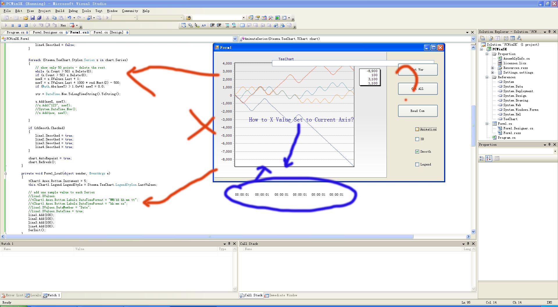

I want to "Set the Bottom Axis to Current Date or Time";but
Post by ifSreven » Fri Nov 28, 2014 10:52 am
I want to "Set the Bottom Axis to Current Date or Time";but Fail; :roll:

Hello!
You could try something like this:
      Line line1 = new Line(tChart1.Chart);
      DateTime dt = DateTime.Today;
      for (int i = 0; i < 10; i++)
        line1.Add(dt, 100);
        dt = dt.AddHours(12);
      tChart1.Axes.Bottom.Labels.DateTimeFormat = "MM/dd hh:mm tt";
