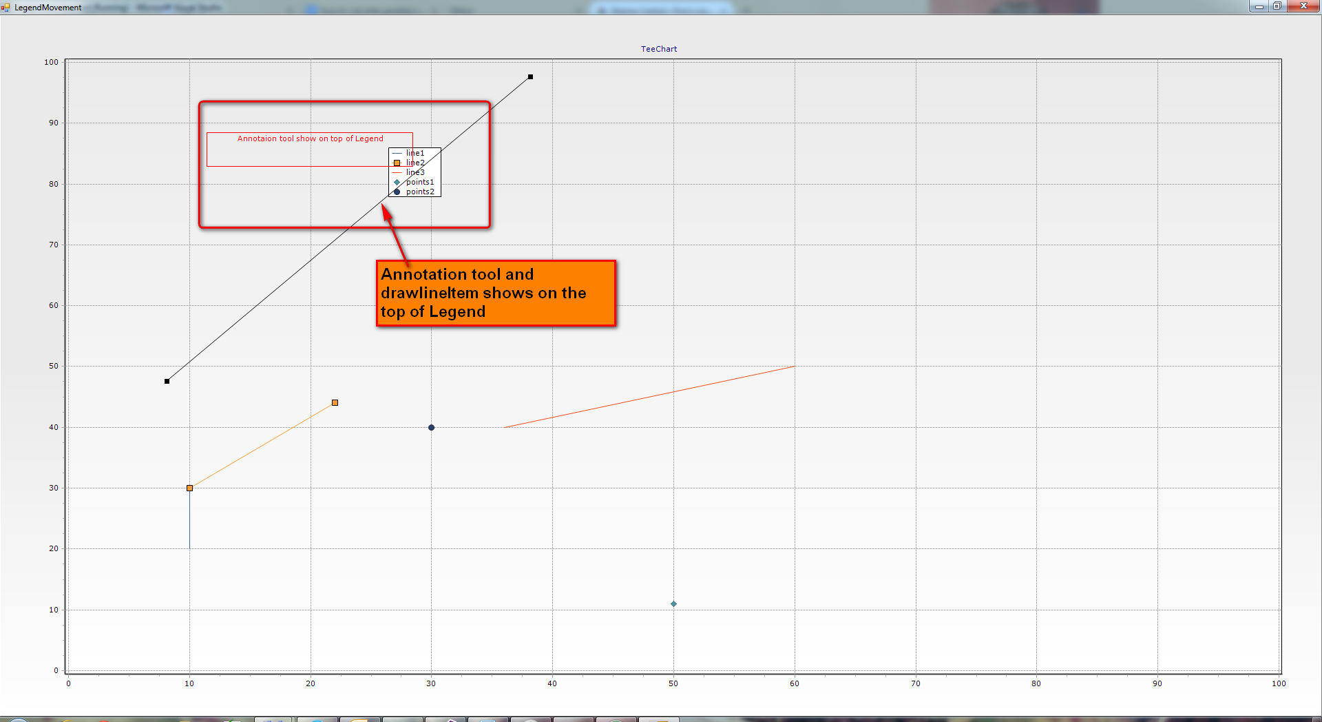

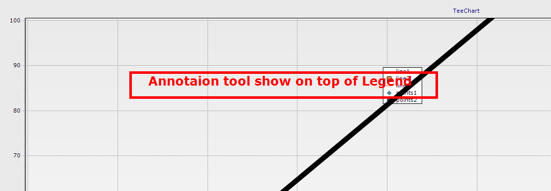

Why Tools are shown above the series as shown in fig.
Tools are shown on the top.
Tool are on tool1.png (123.58 KiB) Viewed 10022 times
Here DrawlineItem and Annotation shown above the Legend . Is there is any way to display Legend above these tools.
Please provide any solution.

I am attaching an image to clarify the issue.
Legend must be on top.
As shown in image, that Annotation Tool(Rectangle that is shown with text) and a DrawLineItem Tool(Thick Black line shown) covers the legend or we can say we can not see complete legend clearly. So here we want that Legend must be shown above these tools so we can read legend clearly.

amol wrote: As shown in image, that Annotation Tool(Rectangle that is shown with text) and a DrawLineItem Tool(Thick Black line shown) covers the legend or we can say we can not see complete legend clearly. So here we want that Legend must be shown above these tools so we can read legend clearly.
Seeing this image I have the impression the legend is manually set to a custom position, it is not using default positions (LegendAlignments.Left, LegendAlignments.Right, LegendAlignments.Top and LegendAlignments.Bottom). So you should calculate the legend position not to overlap either with the Annotation and DrawLine tools.
If you want us to look at the issue with more detail please send a Short, Self Contained, Correct (Compilable), Example project to reproduce the problem here.
