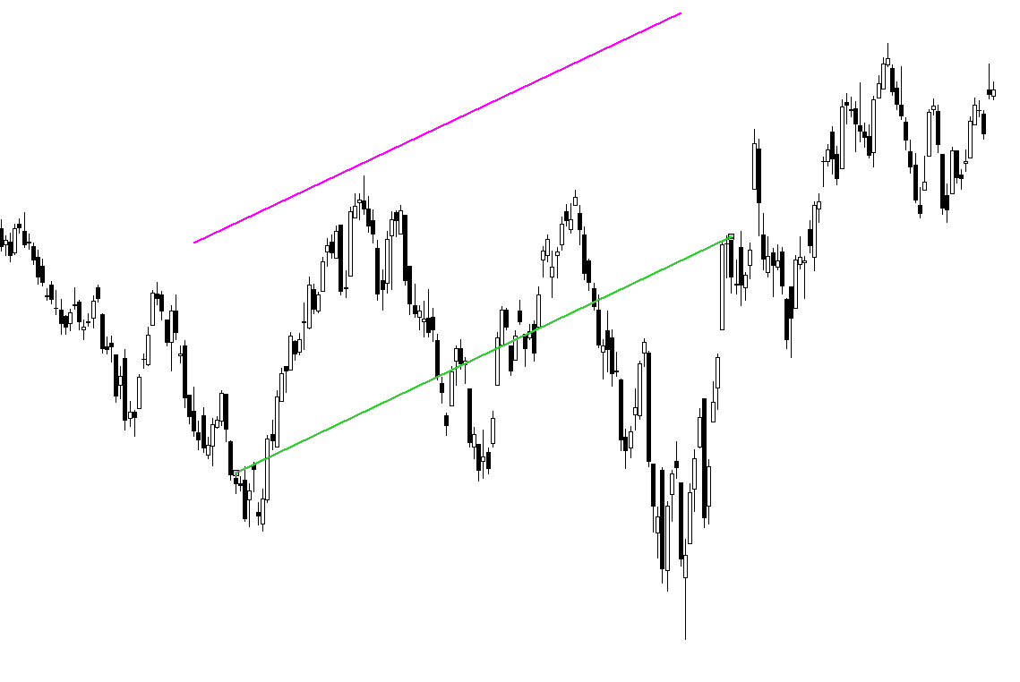

1] Draw Line with Snap to Point (Check below Image 1):
As shown in the screenshot we draw two trend lines. The Pink Line is normal line without Snap to Point Option. Whereas the Green Line as you see are attached to series points. Green line is drawn using Snap to Point Option. Both Start and End points of Green Line are attached to CandleStick Series.
Image (1): Snap to Point Trend Line

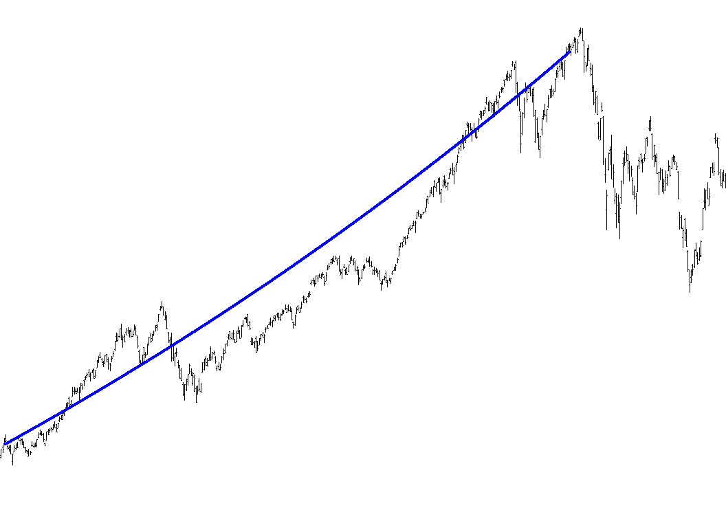

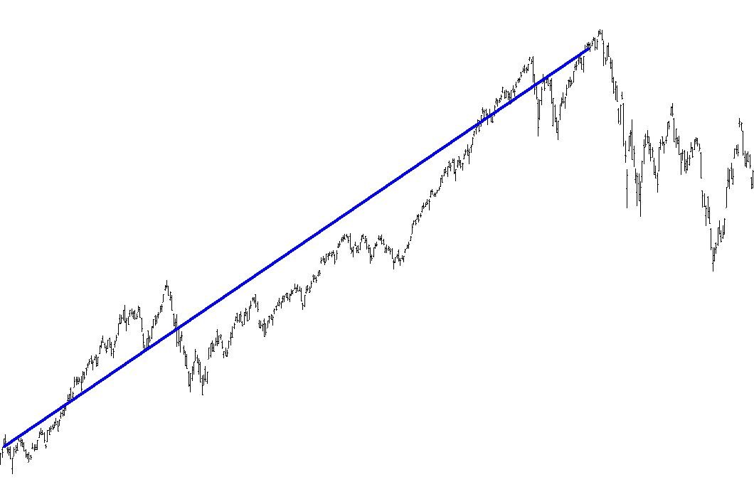

2] Semi Log Aware Line
Image 2 shows Line Drawn on series whose Logarithmic Property is Set to True.
Whereas Image 3 shows the same Line on same series whose Logarithmic Property is Set to False.
By clearly looking at both the image, you can clearly make out the difference in Image 3 that the blue line is now has the appearance of Curved Line.
The line shown in Image 3 is actual Semi Log Aware Trend Line.
Image (2): Line Drawn on Logarithmic Series
Image (3): Line Drawn on Same Series (with Logarithmic = Off
