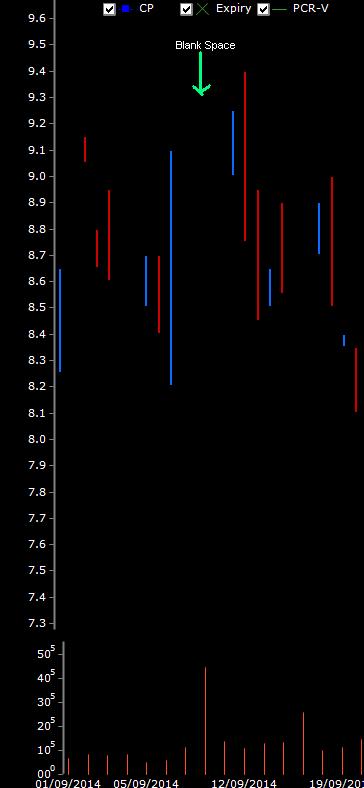

while drawing Candle Stick Graph in Teechart.Net. When datavalue is not present for particular date it shows blank space (e.g.for Saturday, Sunday and Holiday.). previously when we were using Ocx version the candlestick graph was continuous without any blank space
Kindly see the attached file

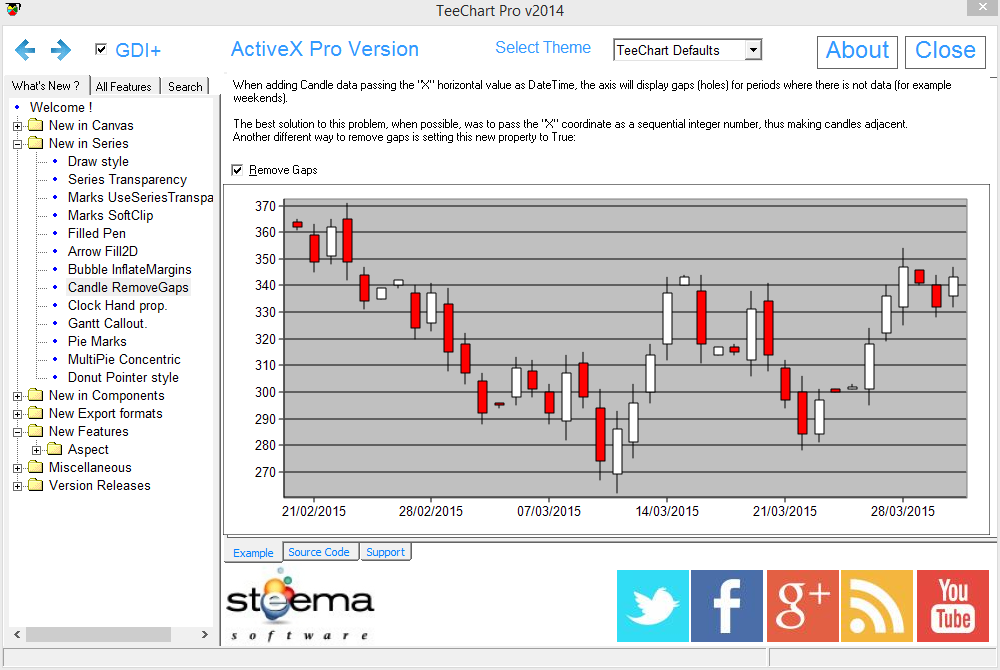

There is an example in the Feature Demo under:
%Program Files%\Steema Software\Steema TeeChart for .NET 201X 4.1.201X.XXXXX\Examples\DemoProject\bin\ExecutableDemo\TeeChartNetExamples.exe
Go to the "All Features tab" and then
Welcome !\Chart styles\Financial\Candle (OHLC)\Axis Labels no Weekends

In the latest release notes we have:
This property can be used like this:
    Candle series1;
      series1 = new Candle(tChart1.Chart);
      Random r = new Random();
      double tmpOpen;
      double tmpClose;
      int count = 0;
      DateTime dt = DateTime.Today;
      TimeSpan ts = TimeSpan.FromDays(1);
      for (int t = 0; t < 13; t++)
        tmpOpen = r.Next(100);
        tmpClose = tmpOpen - r.Next(100);
        if (dt.DayOfWeek != DayOfWeek.Saturday & dt.DayOfWeek !=
          DayOfWeek.Sunday)
          ++count;
          series1.Add(dt, tmpOpen, tmpOpen + r.Next(50),
            tmpClose - r.Next(50), tmpClose);
        dt += ts;
    private void checkBox1_CheckedChanged(object sender, EventArgs e)
      series1.RemoveGaps = checkBox1.Checked;
