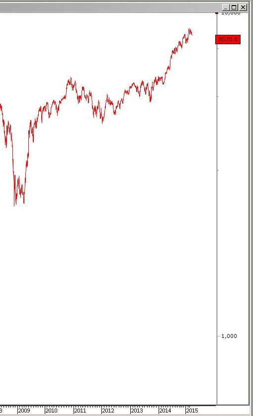

We have one requirement wherein we need to show the Chart of Semi Log Scale (Logarithmic==True). The required final output should be as shown in following image:
Reuired Semi Log Scale
Actual Semi Log Scale.JPG (33.63 KiB) Viewed 5413 times
TeeChart works fine with Logarithmic Scale, but it does not show axis labels as shown in above image.
Following is the image showing TeeChart with Logarithmic=True:
TeeChart Semi Log Scale
TeeChart Semi Log Scale.JPG (26.61 KiB) Viewed 5410 times

There are several ways to control axis labelling, two of which are shown here:
    FastLine series1 = new FastLine();
      tChart1.Series.Add(series1);
      series1.VertAxis = VerticalAxis.Right;
      Random rnd = new Random();
      for (int i = 0; i < 200; i++)
        series1.Add(i, rnd.Next(10000));
      tChart1.Axes.Right.Increment = 500;
      //tChart1.GetNextAxisLabel += tChart1_GetNextAxisLabel;
      tChart1.Axes.Right.Logarithmic = true;
    void tChart1_GetNextAxisLabel(object sender, GetNextAxisLabelEventArgs e)
      if (((Steema.TeeChart.Axis)sender).Equals(tChart1.Axes.Right))
        e.Stop = false;
        switch (e.LabelIndex)
          case 0:
            e.LabelValue = 50;
            break;
          case 1:
            e.LabelValue = 100;
            break;
          case 2:
            e.LabelValue = 200;
            break;
          case 3:
            e.LabelValue = 500;
            break;
          case 4:
            e.LabelValue = 1000;
            break;
          case 5:
            e.LabelValue = 2000;
            break;
          case 6:
            e.LabelValue = 5000;
            break;
          case 7:
            e.LabelValue = 10000;
            break;
          default:
            e.Stop = true;
            break;
Do either of these strategies help you?
