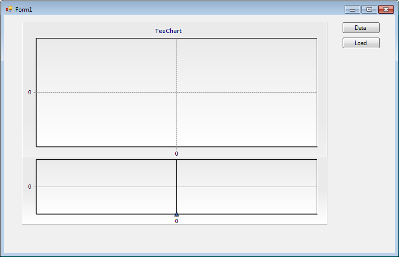

When I run my sample application, I get this window:
The ScrollPager is positioned to minimum and maximum 0, which is acceptable because no data is available for Series.

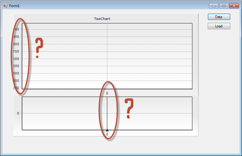

Now when I load data pressing the Data button (= line1.FillSampleValues(100);) I get this:
The ScrollPager is still positioned to 0 and I can't move the minimum or maximum.
What's wrong? Do I need to use a 'redraw' and where can I find this?

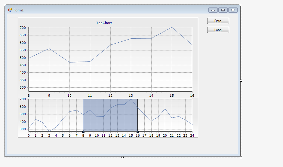

The ScrollPager tool needs to be reassigned the series once this has had its data changed, i.e.
      series1.FillSampleValues();
      tool1.Series = series1;
