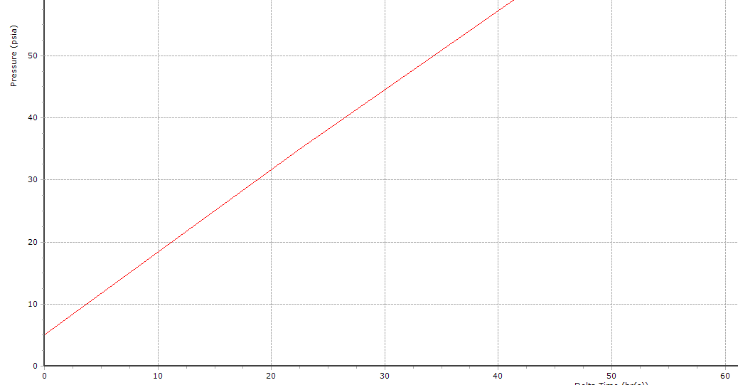

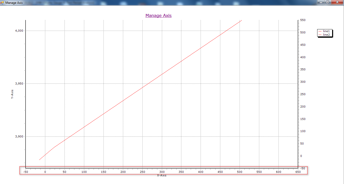

The below figure(1) shows according to all above input but not same as below figure (2).
Our max, min, tick increment and total no of tick are same but minor per major tick are not. So kindly let us know how to implement minor per major ticks in TChart 2012.
Figure-1
Figure-2
In figure-2, each minor tick has increment of 50, so is there any way in Steema Tchart to set increment of axis with respect to minor tick.
So, kindly suggest how to manage bottom axis of (Fig-1) according to (Fig-2) in TChart 2012 version, with respect to labels, ticks, minimum value, maximum value and grid lines of the axis.

Hi PlanoResearch,
I'm not sure about which is your exact question. However, you can have bottom axis in the example you sent (figure1) as in figure2 example using this code:
          tChart1.Axes.Bottom.SetMinMax(-50.0, 650);
          tChart1.Axes.Bottom.Increment = 200;
          tChart1.Axes.Bottom.IncrementOffset = 50;
          tChart1.Axes.Bottom.Labels.OnAxis = true;
          tChart1.Axes.Bottom.MinorTicks.Length = 4;
You can set Increment relative to the number of minor ticks using something like this:
          tChart1.Axes.Bottom.Increment = (tChart1.Axes.Bottom.MinorTickCount + 1) * 50;
Is this what you were looking for? Otherwise please provide more detailed information about your exact requirements.

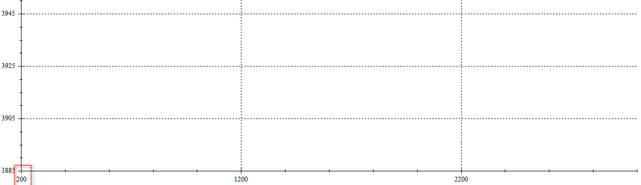

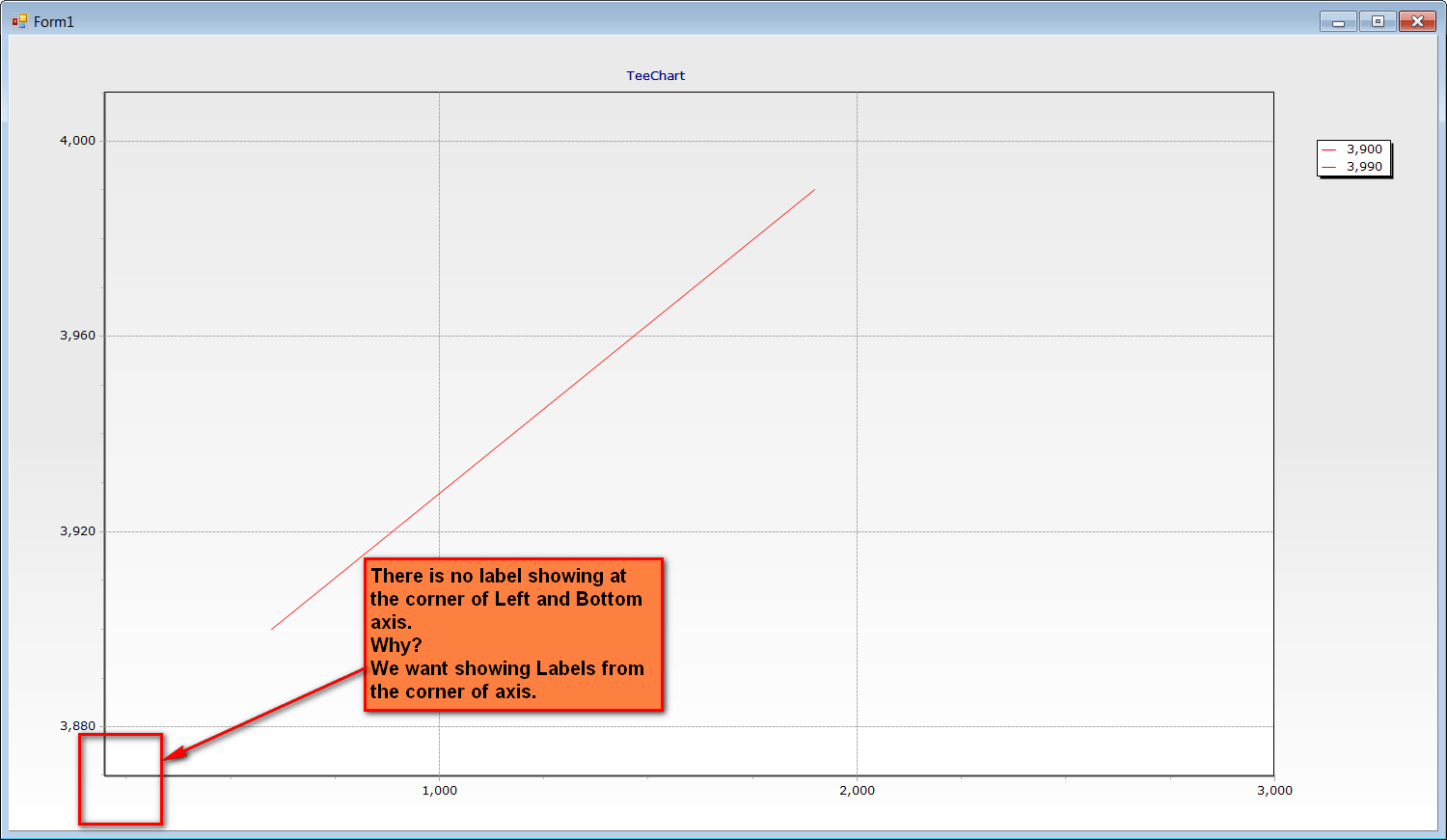

As shown in below figure-1, the left Axis label start showing from initial position which looks correct but on the other hand labels of bottom axis not start showing from initial position of axis.
We want to show axis labels of all axis from initial position as shown in Fig.2

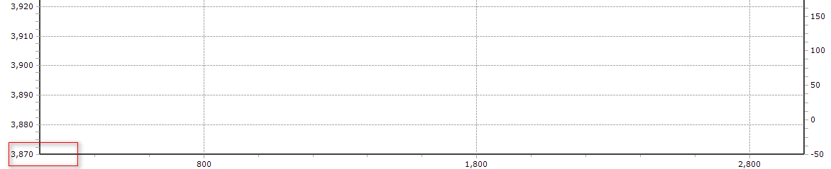

Hi Steema Support,
Thanks for your reply.
We are using the "OnAxis" property as shown below but it does not do anything.
Labels at the corner.png (41.11 KiB) Viewed 30015 times
We are attaching a new demo for better understanding.Please provide any solution asap.

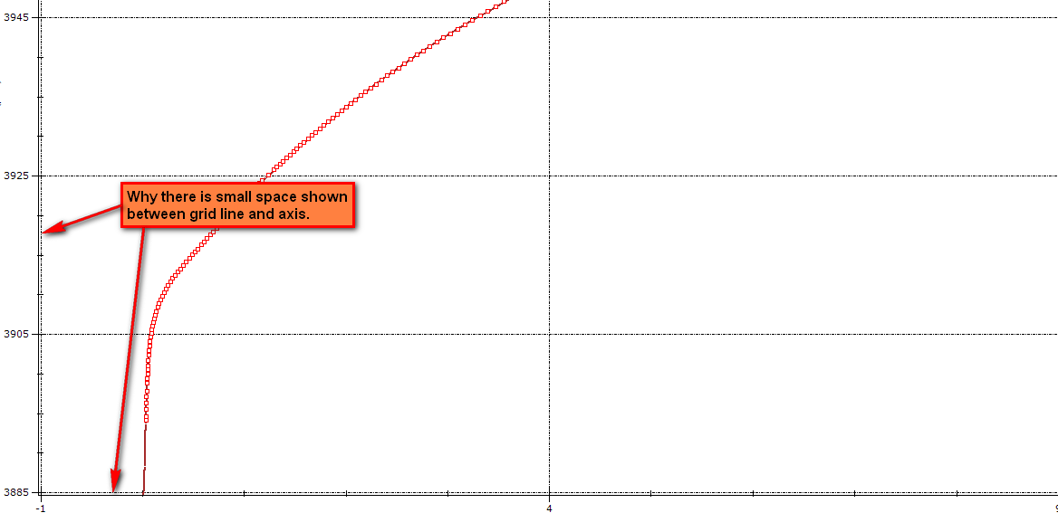

But we are facing one more problem i.e. shown in Figure 1. It shows small space between axis line and Grid line(Starting grid line) why? we are using MinimumOffset, MaximumOffset and IncrementOffset value 0(zero).
Figure 1
We want no space there as shown in figure 2 below.there is no space shown and grid line created with uniform interval.
please provide any solution. Thanks in advance.

Hi Steema Support,
We are attaching a Demo project for the same and will reproduce the problem(It shows small space between axis line and Grid line).
According to my understanding When we set line.Pointer.visible=True; then it shows the problem as given in demo.
Kindly provide any solution asap.
PlanoResearch
ManageAxis.rar
Demo
(57.31 KiB) Downloaded 1299 times
Re: Managing Axis Increment
Post by Christopher » Mon Aug 31, 2015 1:48 pm
amol wrote:According to my understanding When we set line.Pointer.visible=True; then it shows the problem as given in demo.
I think you can resolve this with:
line.Pointer.InflateMargins = false;
