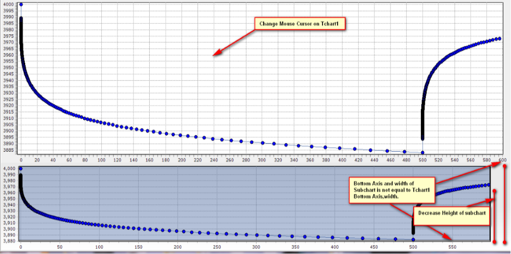

1- When first time chart opens, Bottom axis of subchart is not shown. So how it will display?
Image 1
2- How to set Bottom Axis and width of subchart.
image 2
3- How decrease the height of Subchart.
4- How to Change the mouse Cursor on Tchart.
5- How to Know on Which Chart (Tchart,Subchart) mouse Cursor is Present.
6- Add or Delete some points of Line from Tchart. Then how subchart points will be updated.
7- How to know on which Tchart or Subchart Mouse Click is performed.

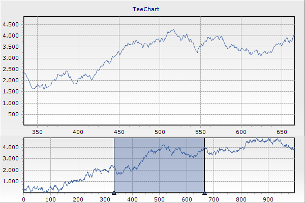

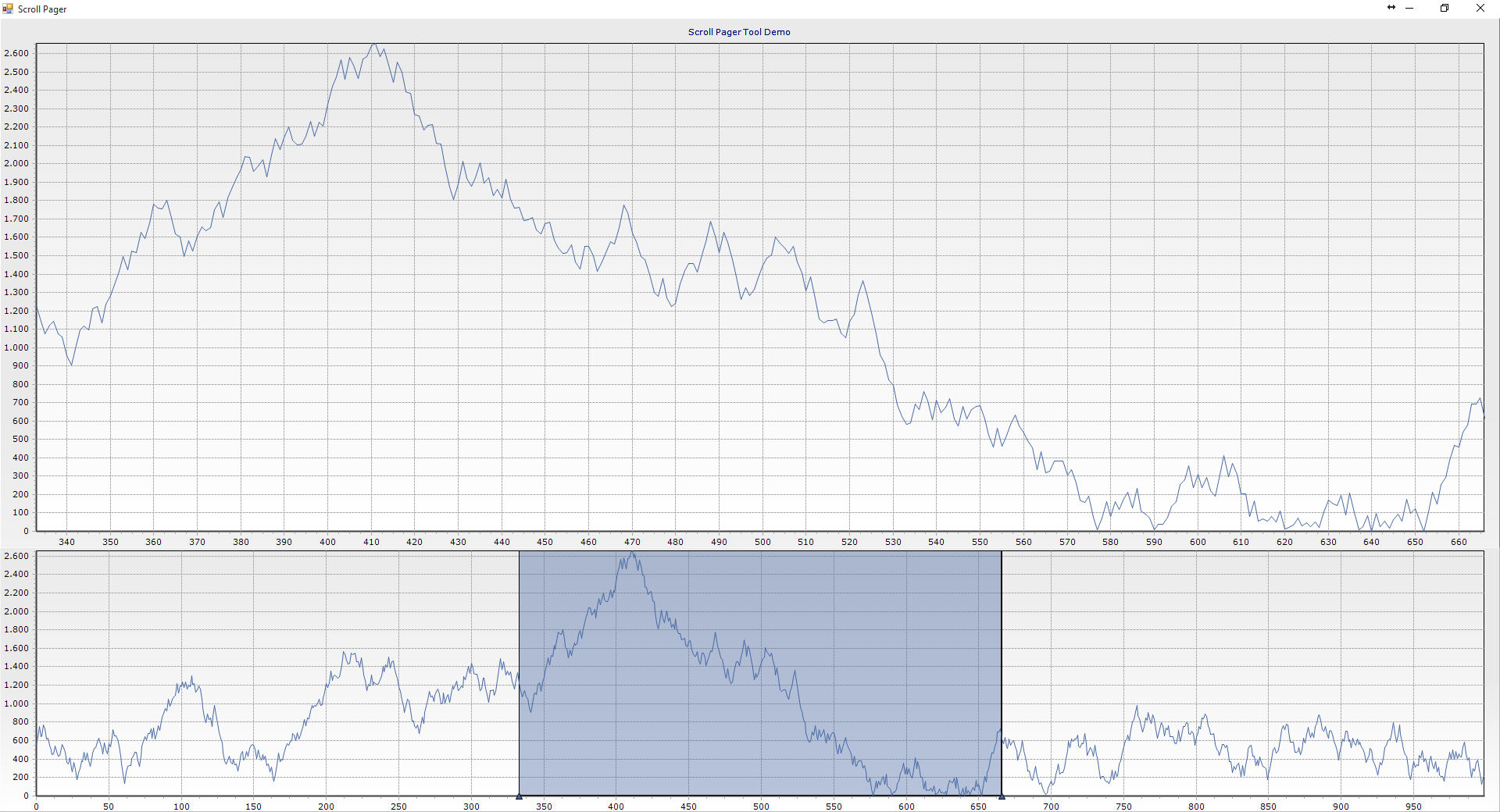

It produces this chart:
So can you please check your code to find out which is causing it? If the problems persists modify the code snippet above or attach a simple example project we can run "as-is" to reproduce the problem here.

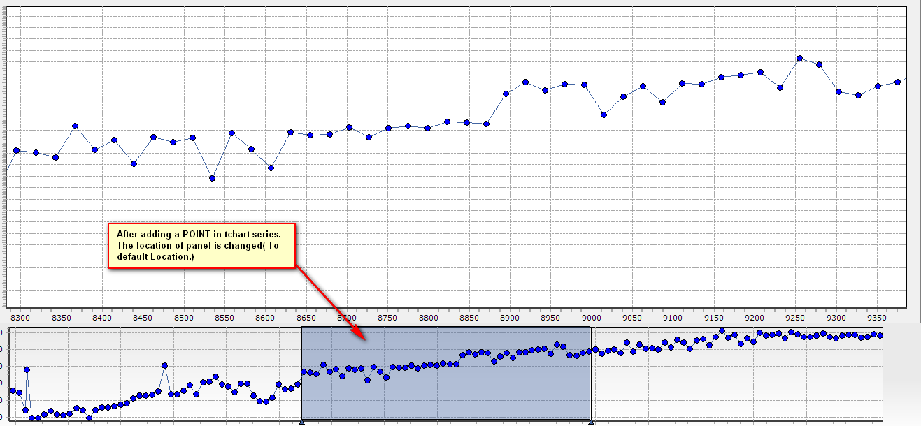

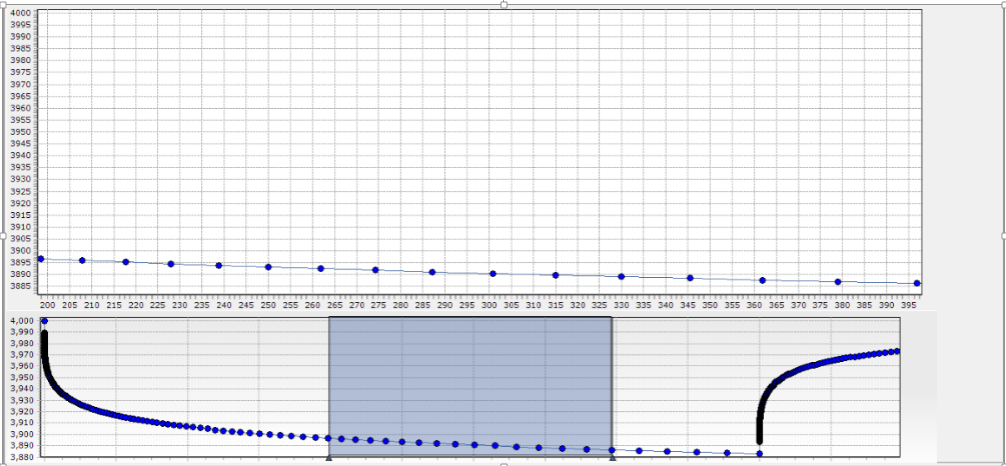

1. In Sub chart , Move the Zoom Panel.
Image 1

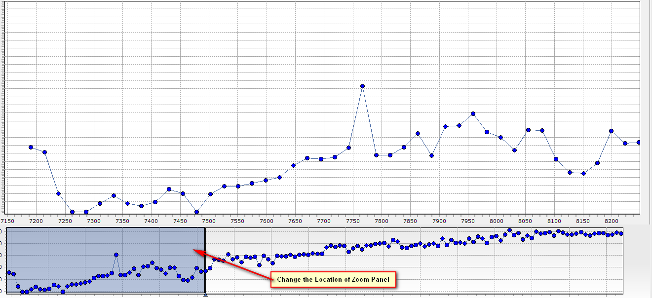

2. Add a point in the Series of Tchart. The Location of Zoom panel is automatically change ( to Default Location).
Image 2

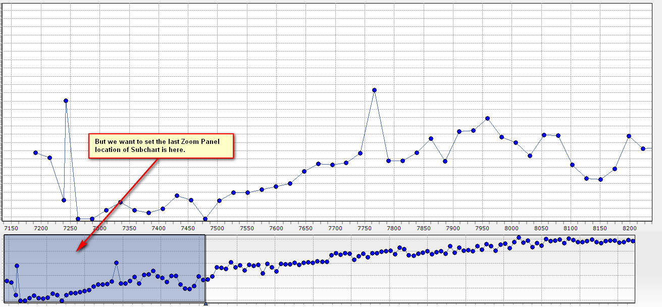

But we want to preserve/set the last Zoom Panel location of Subchart is here.
Image 3
3. After Add point in line series of Tchart, Update subchart series and panel location is given as below,
double start =ScrollPagertool.ColorBandTool.Start;
double end = ScrollPagertool.ColorBandTool.End;
ScrollPagertool.SubChartTChart.Series.Clear();
ScrollPagertool.Series = line;
ScrollPagertool.ColorBandTool.Start = start;
ScrollPagertool.ColorBandTool.End = end;
But it does not giving desired result.
Image 3

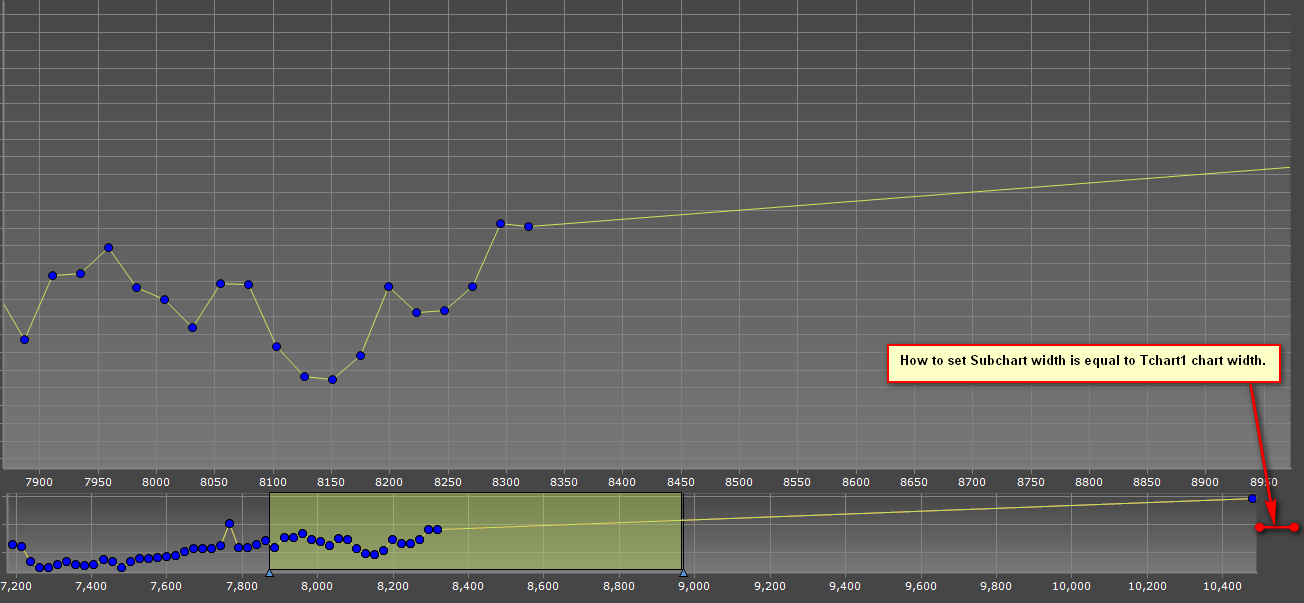

1. How to set subchart width is equal to tchart1 chart width.
Fig1
Please give the solution asap.
thanks
PlanoResearch
Re: ScrollPager tool
Post by Christopher » Tue Sep 01, 2015 9:31 am
amol wrote:1. How to set subchart width is equal to tchart1 chart width.
Could you please post a simple example project with which we can reproduce your problem here?

we have also assign "tool.Series = series;". But Tchart,Subchart width seems not equal.
we want to show just Like as scrollpager1.PNG Image Tchart,Subchart width.
