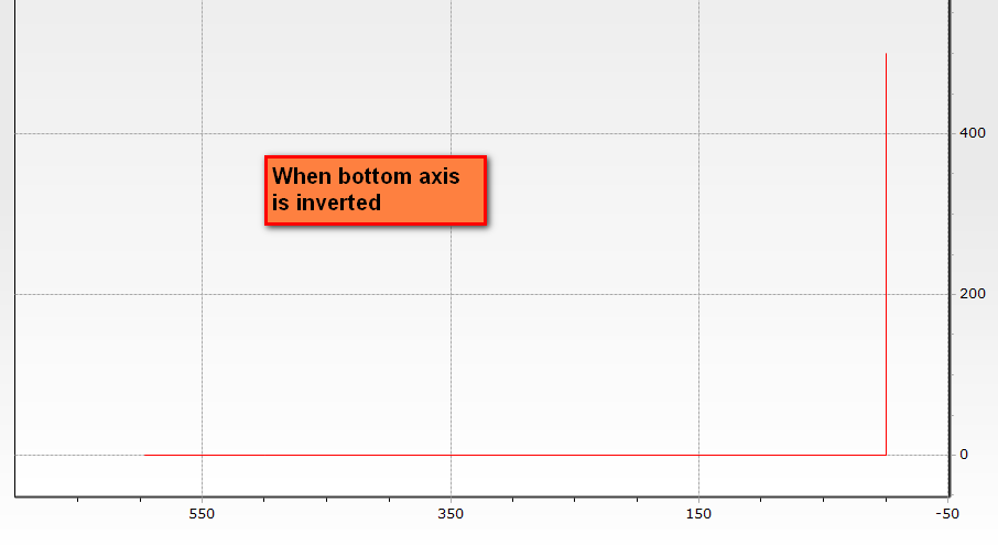

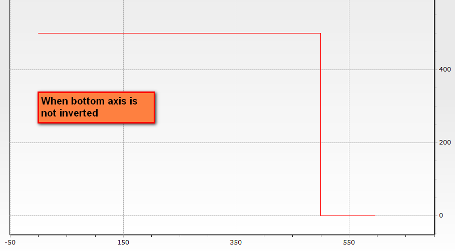

We are creating line using series and setting property "line.Stairs=True;" and "line.VertAxis = VerticalAxis.Right;".
But we press button "Invert" to invert bottom axis but it does not shows reflection on line properly as shown in Fig. 2
Fig 1: shows line without axis inverted.
Fig 1
Fig 1.png (9.66 KiB) Viewed 7910 times
Fig 2: shows line with axis inverted.
Fig 2
Fig 2.png (9.98 KiB) Viewed 7905 times

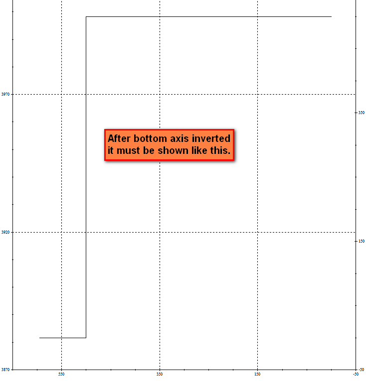

Hi Steema Support,
Yes, you right when we see the value then it shows the correct value but line shown in the chart is not correctly inverted.
When line inverted correctlythen it looks like fig 1
Fig1
fig 3.png (10.33 KiB) Viewed 7894 times
