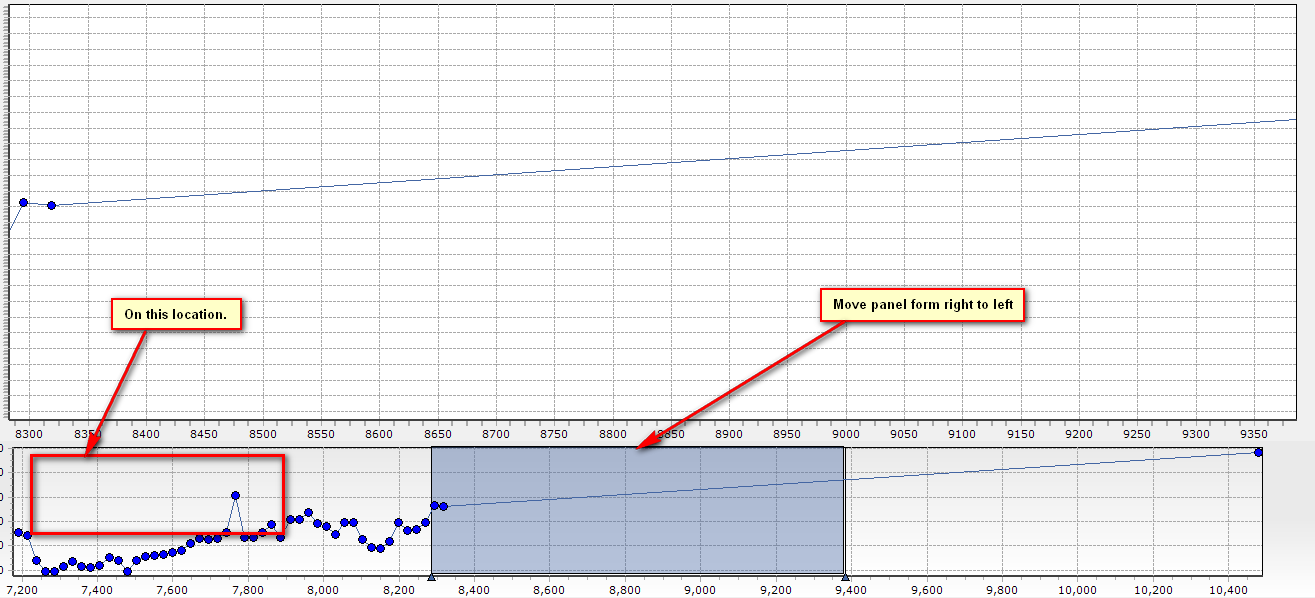

1. Change the panel positon from right to left.
Fig 1

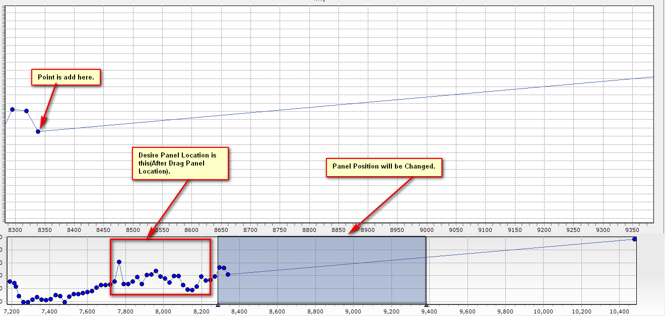

2. Add a point in Tchart and Upadate Subchart series. But zoom Panel location is Change.When we add a point on Tchart series , we want to not change Panel Location.
Fig 2

amol wrote:1. Change the panel positon from right to left.
I'm not sure of the requirement here - clicking and dragging on the panel easily changes its position, right?
amol wrote:2. Add a point in Tchart and Upadate Subchart series. But zoom Panel location is Change.When we add a point on Tchart series , we want to not change Panel Location.
Which code are you using to update the series?

Update Subchart Series from below Code,
ScrollPagertool.SubChartTChart.Series.Clear();
ScrollPagertool.Series = line;
Re: ScrollPager Zoom Panel Location.
Post by Christopher » Tue Sep 01, 2015 9:28 am
amol wrote: ScrollPagertool.SubChartTChart.Series.Clear();
Okay, in which case you can try:
      double min = tChart1.Axes.Bottom.Minimum;
      double max = tChart1.Axes.Bottom.Maximum;
      double start = tool.ColorBandTool.Start;
      double end = tool.ColorBandTool.End;
      series.Add(150, 10);
      tool.Series = series;
      tChart1.Axes.Bottom.Minimum = min;
      tChart1.Axes.Bottom.Maximum = max;
      tool.ColorBandTool.Start = start;
      tool.ColorBandTool.End = end;
amol

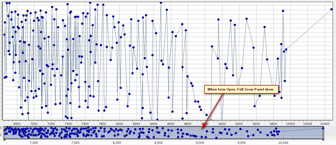

But we have one more query given as below,
1. We want open full ScrollPager Zoom Panel in chart when first time chart open.
Zoom Panel.png (49.51 KiB) Viewed 15457 times
Post by Christopher » Thu Sep 03, 2015 12:56 pm
amol wrote:1. We want open full ScrollPager Zoom Panel in chart when first time chart open.
You can try:
    Line series1;
    ScrollPager tool;
      series1 = new Line(tChart1.Chart);
      series1.FillSampleValues(200);
      tool = new ScrollPager(tChart1.Chart);
      tool.Series = series1;
      tChart1.Draw();
      tChart1.Axes.Bottom.Minimum = series1.XValues.Minimum + 1;
      tChart1.Axes.Bottom.Maximum = series1.XValues.Maximum - 1;
