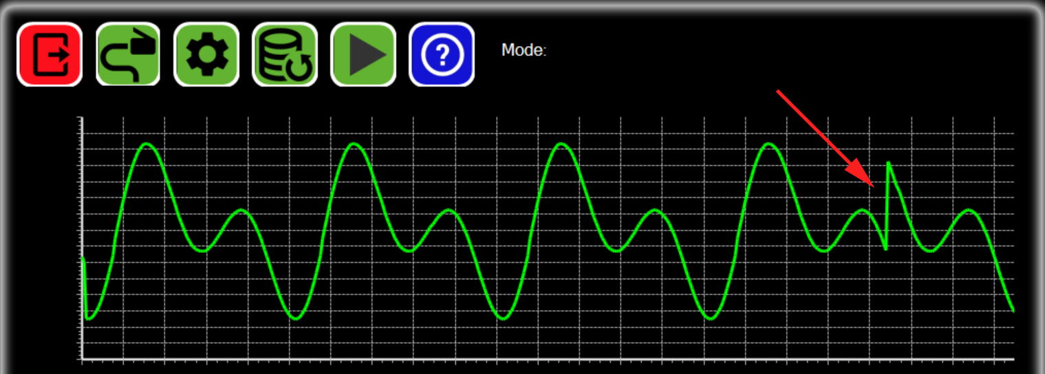

I'm attempting to emulate 'Oscilloscopic' behaviour of the kind found in ECG Monitors.
The following code snippet is called by a plotting timer every 20 mSecs.
case OpMode.File:
short val;
if (Pressure_Data.TryDequeue(out val)) //If data points are available...
if (Wave2Graph.Series[0].Count > Wave2Graph.Axes.Bottom.Maximum) //If we have at least one 'screen' full of data
{ Wave2Graph.Series[0].Delete(Wave2GraphCursor); }
Wave2Graph.Series[0].Add(Wave2GraphCursor++, val);
if (Wave2GraphCursor > Wave2Graph.Axes.Bottom.Maximum)
{ Wave2GraphCursor = 0; }
if (Wave2GraphCursor % SIZEOFPRESSURERECORD == 0)
{ GetNextDORecord(); } //Get the next sequence of pressure points...
break;
Once 'Axes.Bottom' data points have been drawn, the plotting cursor is decremented to zero, and plotting recommences from the left hand side of the graph. In this manner, the maximum size of the plotted series is constrained to 'Axes.Bottom' datapoints.
Under these circumstances, how do I prevent a line being drawn from the most recently entered point to the next point in the series (as is indicated by the red arrow in the attached image)? I've tried add nulls and transparent data points, but can't make it work.
Alternatively, can anyone point me at a working dot.net example of such behaviour?

- Oscilloscope.png (93.61 KiB) Viewed 18944 times

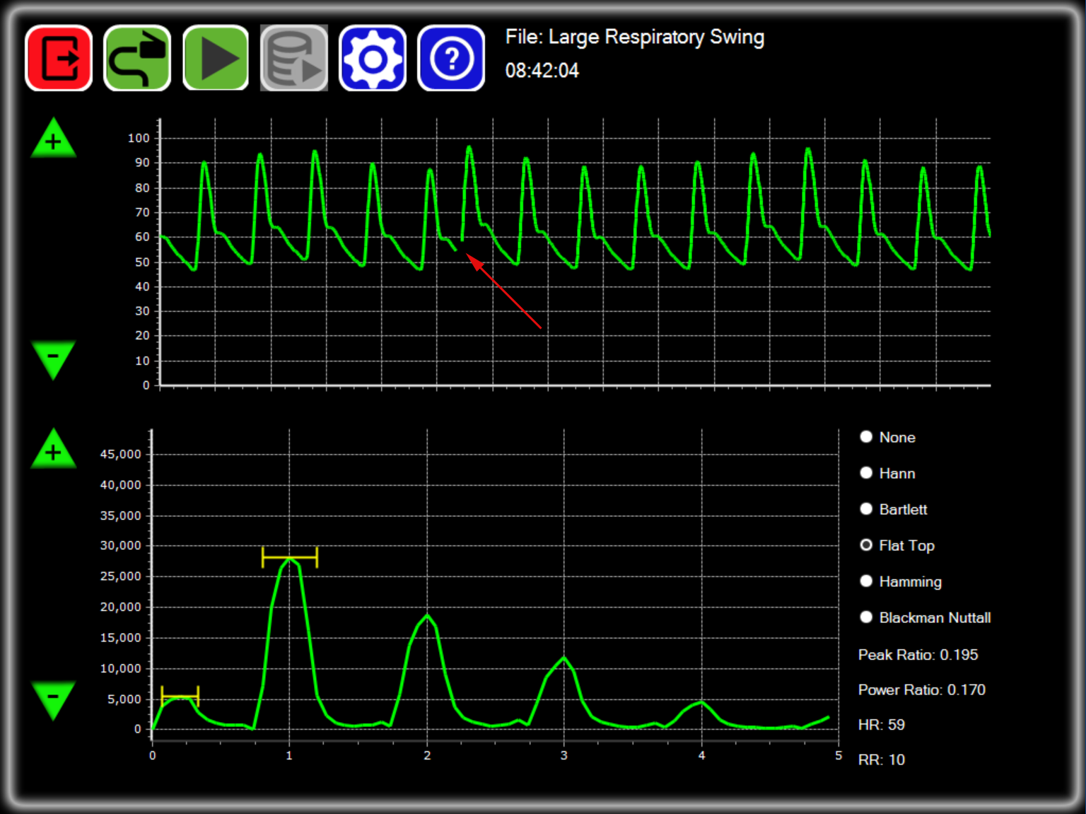

Here's a screenshot from my application where the 'Scan Cursor' (Arrowed in red') is working correctly. The scan cursor width in this case is 10 pixels, and appears as a black gap. The effect is achieved by toggling odd and even scan series as 'Active' and 'Inactive' and deleting points from the inactive series while drawing to the active series.
Notwithstanding these difficulties, I'm totally impressed with TeeChart!! - As you can probably gather from the screenshot, I'm able to plot thousands of data points per second - while performing FFT's on the waveform at 2 Hz!
Next week, I hope to start migrating the app from this PC version to a Xamarin implementation. Can you point me at any examples which demonstrate very fast plotting (particularly on Android devices)?
Thank you again,
Andy

I now need to display the two-dimensional frequency spectrum shown in the lower chart in the image above on a 3D surface chart.
The application performs the FFT @ 2Hz. After each transformation the magnitudes of each frequency are accumulated into an array (dimensions double[100]) – where each element of the array represents a frequency range (‘bin’) (X value) and the value contained within the element is the sum of all magnitudes within this frequency range (Y value).
Essentially, I now want to add a ‘Z’ axis (Time) by drawing my double array at 2Hz onto a surface chart such that each time a new FFT array is accumulated, it will be added to the chart with a Z value which had been incremented by 500 mSec (0.5 Hz).
Can you point me at a code snippet which demonstrates the addition of such numerical arrays to a surface plot?
