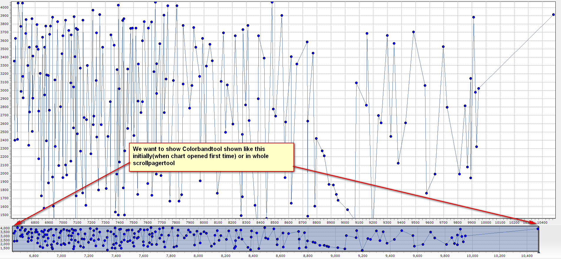

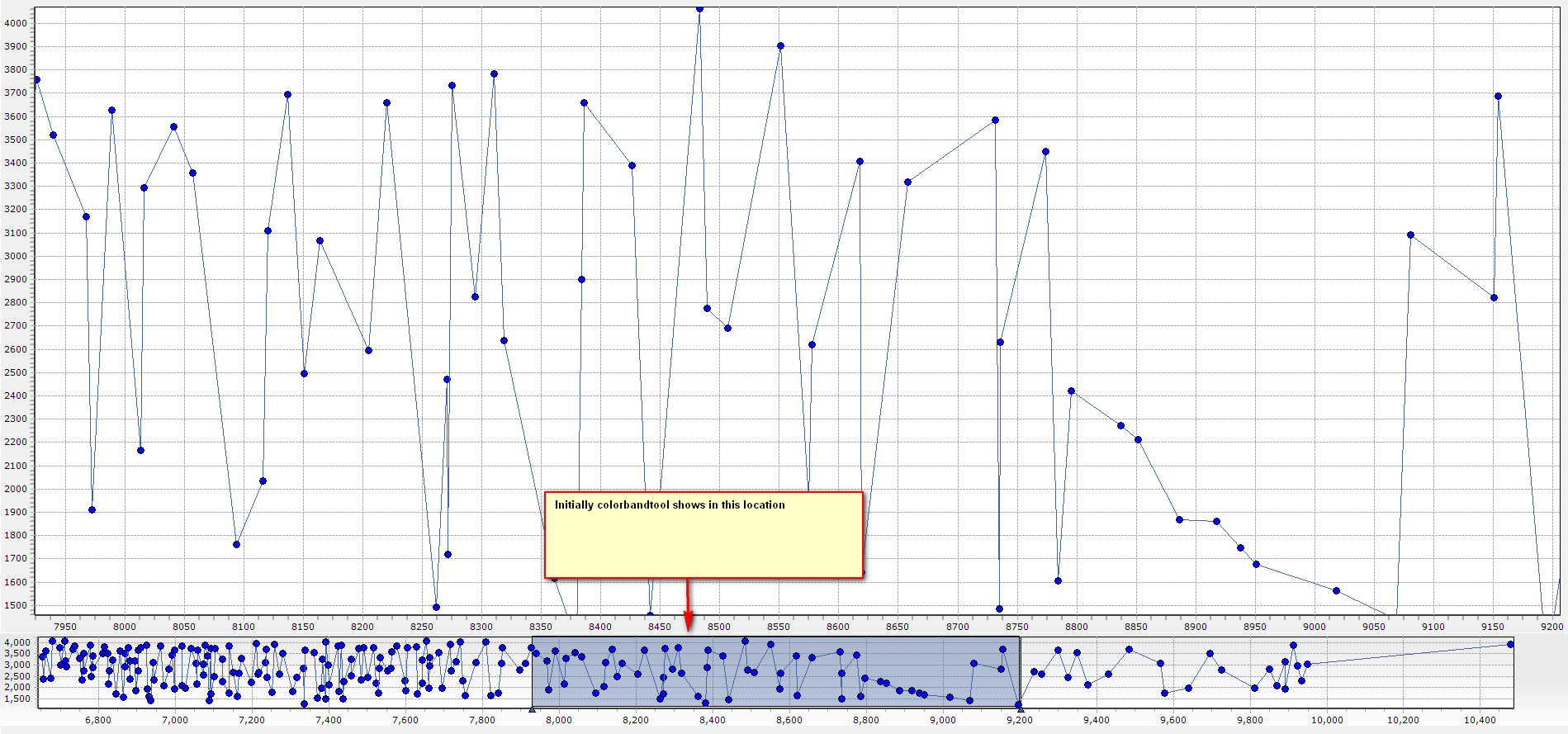

Hi steema,
we are using ScrollPager tool and we have some query given as below,
1. we are setting
ScrollPagertool.SubChartTChart.Axes.Bottom.Minimum = 6200;
ScrollPagertool.SubChartTChart.Axes.Bottom.Maximum= 10500;
we also want to set colorbandtool start and end points initially when we opens chart, currently we are using below code
ScrollPagertool.ColorBandTool.Start= ScrollPagertool.SubChartTChart.Axes.Bottom.Minimum;
ScrollPagertool.ColorBandTool.End= ScrollPagertool.SubChartTChart.Axes.Bottom.Maximum;
but it does not work as shown in img1. as shown
Img 1
we want to show it like img2 as shown below
img 2
2. we want to stop draging of ColorBandTool out side the Scrollpagertool Subchart.
