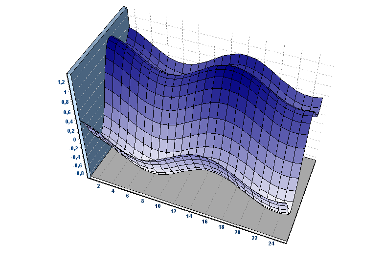

I'm attempting to emulate the surface chart entitled "XZ Grid with Y displacement" from your gallery. I can't find it in your samples. I can reproduce the charting behaviour by activating Open GL, but then the axis labels are not shown properly (See above).
Can you help?

This illustrates the absence of labels with openGL. Also,how do I remove the dashed gray lines from the (invisible) left wall?

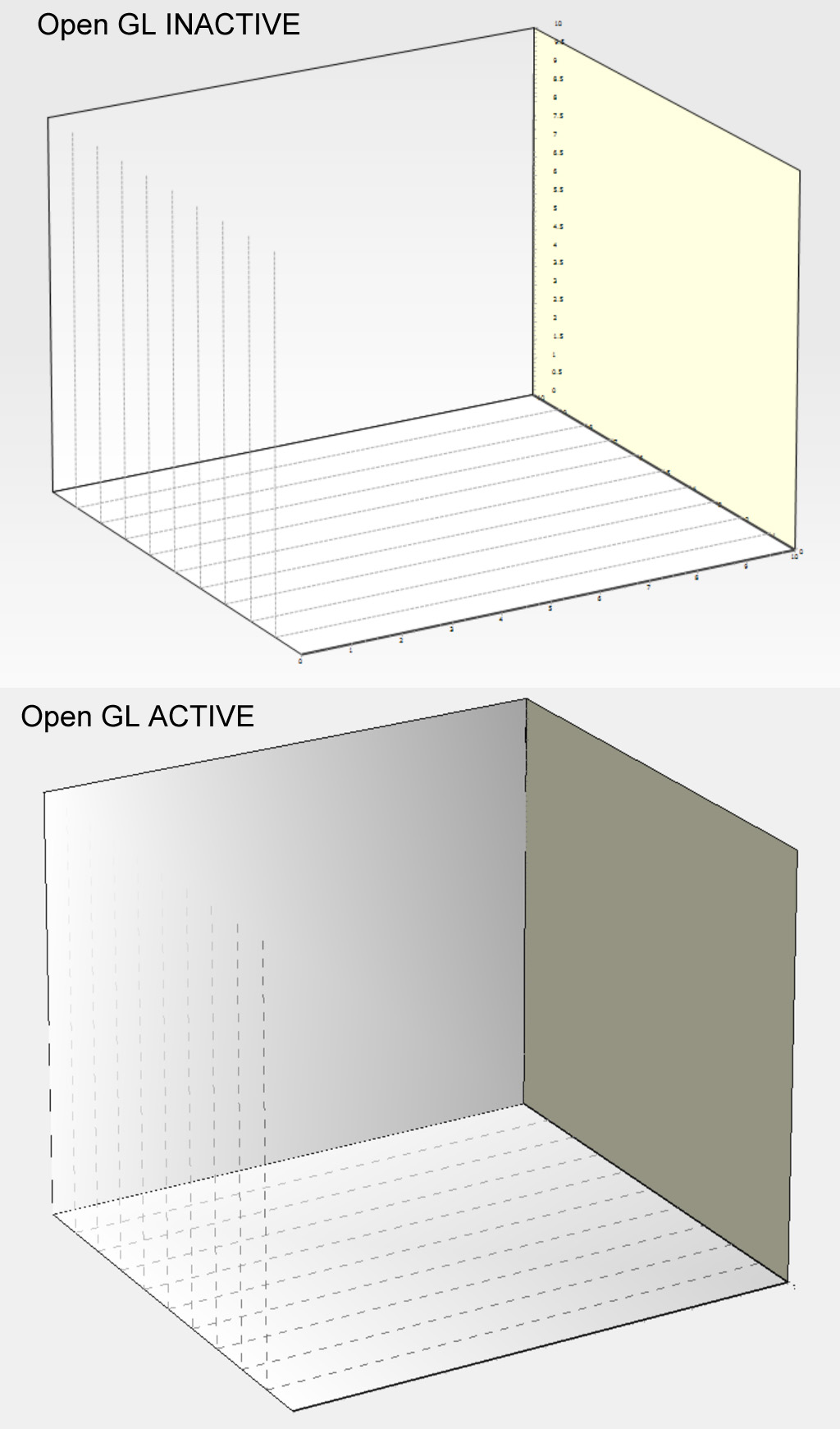

Post by Anaesthesia » Wed Sep 09, 2015 6:37 pm
I'm afraid I'm still having problems.
In the image above, the same chart (without series data) has been rendered with and without OpenGL active.
I commented in or out the code below to achieve this effect:
Steema.TeeChart.Drawing.GL.TeeOpenGL openGL = new Steema.TeeChart.Drawing.GL.TeeOpenGL(SurfaceChart.Chart);
openGL.Active = true;
openGL.ShadeQuality = true;
Can you please explain:
1. How I can remove the dashed gray lines which are positioned on the left and bottom axes?
2. How I can make the axis labelling visible in the OpenGL rendering?
3. How I can increase the font size of the axis labels (It seems to be stuck on 'Verdana 8') whatever I set in the property editor?
Many thanks,
Andy

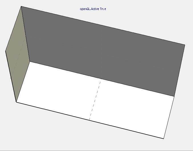

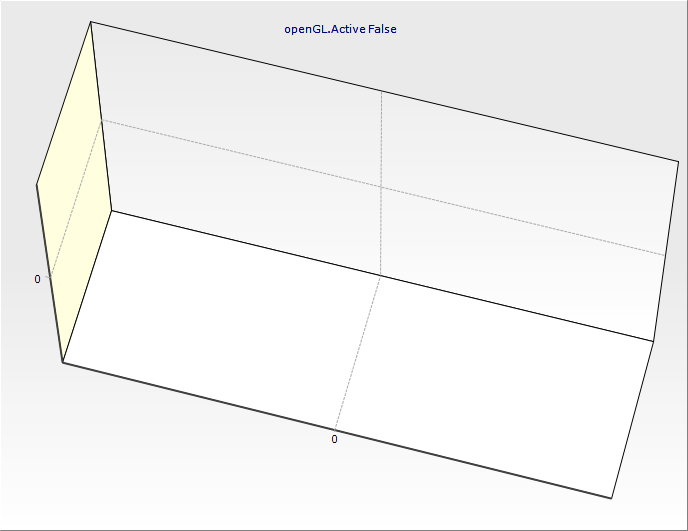

Post by Christopher » Thu Sep 10, 2015 8:27 am
Using this code:
    Surface series;
    Steema.TeeChart.Drawing.GL.TeeOpenGL openGL;
      openGL = new Steema.TeeChart.Drawing.GL.TeeOpenGL(tChart1.Chart);
      series = new Surface(tChart1.Chart);
      //series.FillSampleValues();
      tChart1.Header.Text = "openGL.Active " + openGL.Active;
      tChart1.Aspect.Zoom = 95;
      tChart1.Aspect.Elevation = 295;
      tChart1.Aspect.Perspective = 20;
      tChart1.Aspect.Chart3DPercent = 35;
      tChart1.Draw();
      openGL.Active = !openGL.Active;
      tChart1.Aspect.Zoom = openGL.Active ? 60 : 95;
I obtain the following images:
Can you please modify the above code so I can reproduce your issue here?

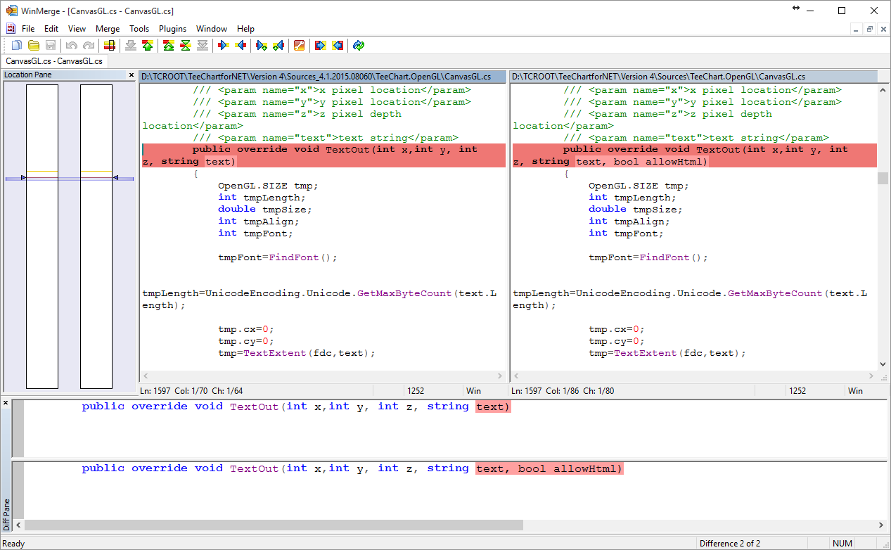

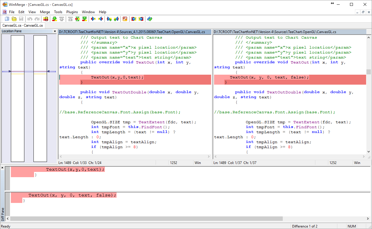

Post by Christopher » Wed Sep 16, 2015 9:21 am
Andy,
Anaesthesia wrote:I have the source code version. Could you let me know what to do?
Of course. There are two changes, both of them to the unit CanvasGL.cs under:
%Program Files%\Steema Software\Steema TeeChart for .NET Source Code 2015 4.1.2015.08060\Sources\TeeChart.OpenGL
and they are shown in the following two images:
Anaesthesia
Posts: 22
Joined: Mon Aug 24, 2015 12:00 am
Re: XZ Grid with Y displacement
Post by Anaesthesia » Wed Sep 16, 2015 7:30 pm
When I replace the method (as shown below) and attempt to re-compile, I get:
Error 1 'Steema.TeeChart.Drawing.GL.GraphicsGL.TextOut(int, int, string, bool)': no suitable method found to override
Code Snippet:
//public override void TextOut(int x, int y, string text)
// TextOut(x,y,0,text);
public override void TextOut(int x, int y, string text, bool allowHtml)
TextOut(x, y, 0, text, false);
Post by Christopher » Wed Sep 16, 2015 7:36 pm
Anaesthesia wrote:When I replace the method (as shown below) and attempt to re-compile, I get:
In the second image I think one can see that the signature to override is slightly different, i.e.
Steema.TeeChart.Drawing.GL.GraphicsGL.TextOut(int, int, int, string, bool)
not
