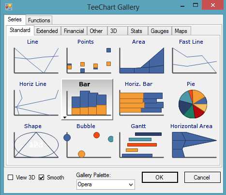

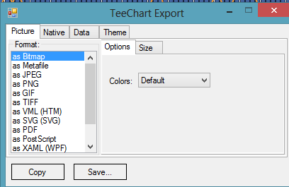

Similar to that of the Chart Editor, are we able to change titles of the series gallery form and export form? - Screenshots attached. If we can, what is the approach? Please suggest.

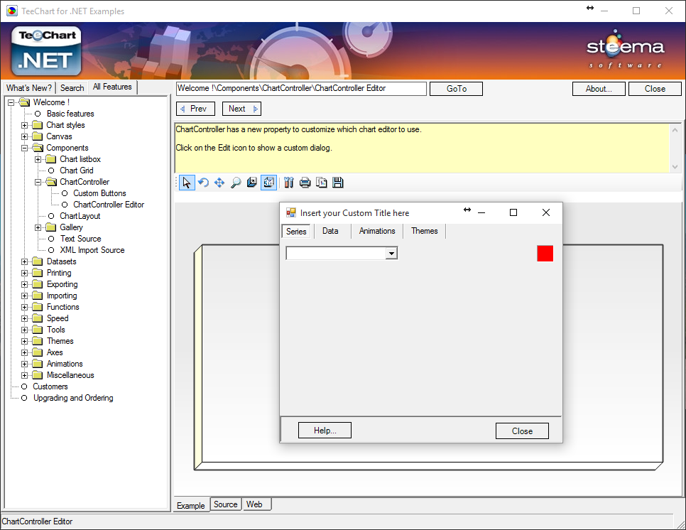

Yes, I think there's an example of what you're looking for in the Feature demo under:
%ProgramFiles(x86)%\Steema Software\Steema TeeChart for .NET 2015 4.1.2015.08060\Examples\DemoProject\bin\ExecutableDemo\TeeChartNetExamples.exe
in:
All Features -> Welcome !\Components\ChartController\ChartController Editor

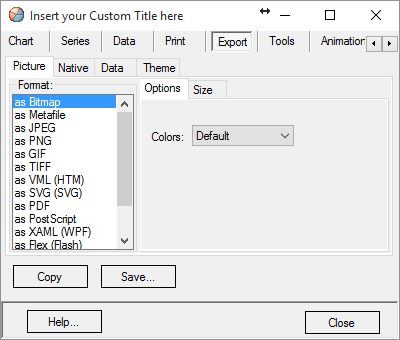

The example I mentioned gives you something like this: So, using the following code:
will give you this:

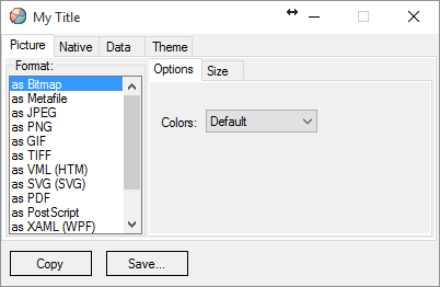

Of course you can instantiate each form "manually" like this:
which gives:

Editor editor1;
editor1 = new Editor(tChart1);
editor1.DefaultTab = Steema.TeeChart.Editors.ChartEditorTabs.Export;
editor1.Title = "Insert your Custom Title here";
editor1.ShowModal();
Steema.TeeChart.Editors.Export.ExportEditor form = new Steema.TeeChart.Editors.Export.ExportEditor(tChart1.Chart);
form.Text = "My Title";
form.ShowDialog();

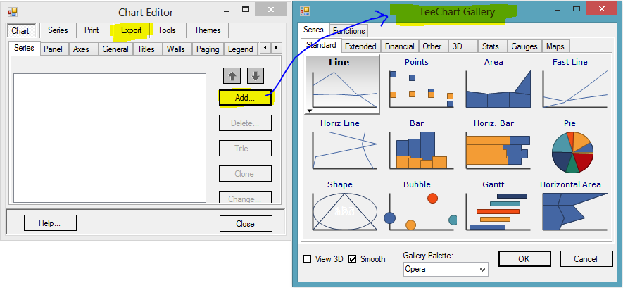

We can instantiate the context forms but how do we handle the event when it is accessed from the chart editor?
Our users are able to change series type or add a new series from the chart editor.
As an example, please follow these steps:
1. From chart editor, click on Series Tab
2. Click on Add tab
3. Form opens with title "Tee Chart Gallery"
(Screenshot attached)
Thanks and regards
Khaled
2. Click on Add tab

In your first post to this thread you posted two attachments, one of the Export Editor and one of the TeeChart Gallery. I trust that you now see that the case of the Export Editor has been resolved by the code I've sent you. The case of the TeeChart Gallery is different - unfortunately, as you correctly say, the only way to change the text on this dialogue is using the source code.

You're correct. We were able to change the export's title using the code for instantiating it outside the chart editor.
Only one that we're left with is the gallery. However, we're thinking of upgrading our subscription which, I believe, will solve our problem.
