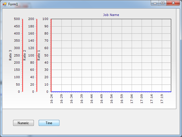

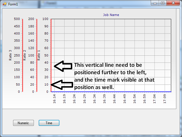

In the 2 images I have posted here, I need to figure out how to make the 1st label and 1st vertical line appear at the leftmost position of the graph regardless of the value.
I have also uploaded the project as well.
This 1st picture shows the discrepancy.
This picture is similar what it should look like - it should have a time mark under the rightmost edge of the graph as well.
Please note that this picture seems to be exactly what I need, however at any given time this is not what it looks like - (see Pic1).

Do you mean something like this:
      Line line1 = new Line(tChart1.Chart);
      Random rnd = new Random();
      DateTime today = DateTime.Today;
      for (int i = 0; i < 20; i++)
        line1.Add(today, rnd.Next(0, 1000));
        today = today.AddDays(1);
      tChart1.Axes.Bottom.Labels.DateTimeFormat = "dd/MM/yyyy";
      tChart1.BeforeDrawAxes += TChart1_BeforeDrawAxes;
    private void TChart1_BeforeDrawAxes(object sender, Graphics3D g)
      Axis bottom = tChart1.Axes.Bottom;
      AxisLabelsItems labels = bottom.Labels.Items;
      double min = bottom.Minimum;
      double max = bottom.Maximum;
      double inc = 1; //one day
      labels.Clear();
      for (double i = min; i <= max; i+=inc)
        labels.Add(i, DateTime.FromOADate(i).ToString(bottom.Labels.DateTimeFormat));
