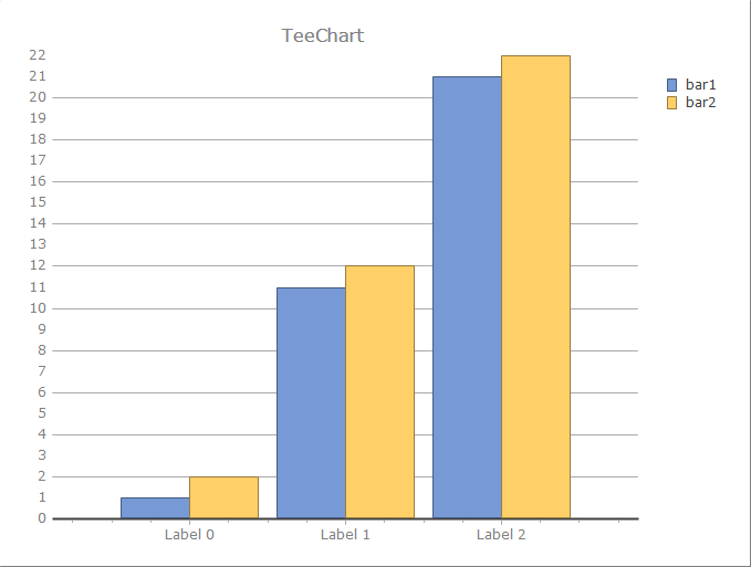

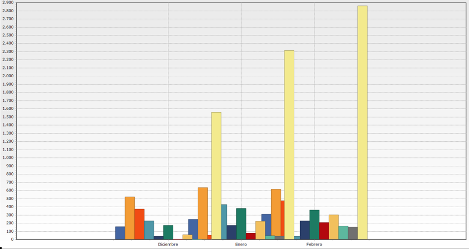

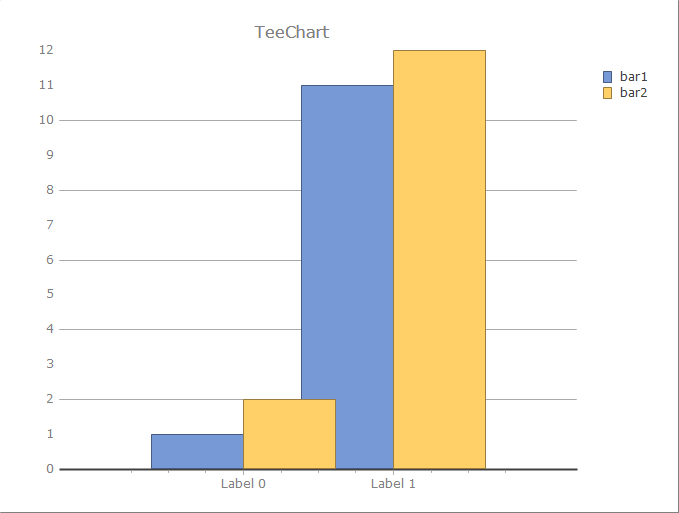

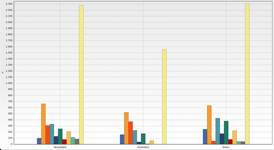

I have just upgraded teechart from a 2 years old version, and it is shown different for bar series.
I attached two charts, one is how it was seen in the previous version, and the other with the bars over other bars.
How can I configurate the distance between bars?

Please find attached the example.
You can change the variable numberofvalues from 2 to 3 and see how if you have 3 values it is show with spaces and with 2 they are one over other. I would like to be always like the 3 values example.

I think you should be able to use the BarWidthPercent property to change this behaviour, e.g.
      int numberofvalues = 2;
      for (int i = 0; i < numberofvalues; i++)
        Steema.TeeChart.Styles.Bar barra = new Steema.TeeChart.Styles.Bar(chart.Chart);
        barra.BarWidthPercent = 60;
        for (int j = 0; j < numberofvalues; j++)
          barra.Labels[j] = "Label " + j.ToString();
          barra.Add(j, j * 10 + 1);
