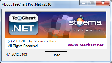

Hi steema,
we are using version of Tchart shown in attached image.
version name
