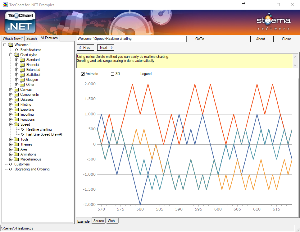

Yes, you can use the Series.Delete method - there is an example of how to do this in the Feature Demo under:
%PROGRAMFILES(x86)%\Steema Software\Steema TeeChart for .NET 2015 4.1.20XX.XXXXX\Examples\DemoProject\bin\ExecutableDemo\TeeChartNetExamples.exe
All Features -> Welcome !\Speed\Realtime charting

Thanks for you suggestion, works perfectly.
