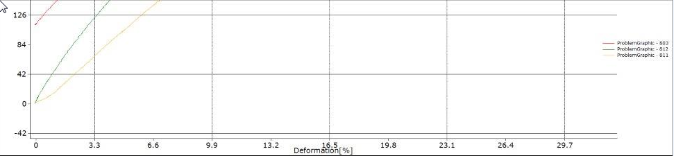

There is only one half of the graph in the exported image when first a pdf and immediatly after a png image is exported.
The exported pdf is right, but the png is drawn incorrectly. TeeChart .net version 4.1.2016.5122
Incomplete Graph of the png image:

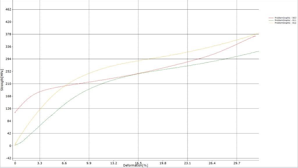

The graph should lik this
Complete Graph of the png image:

Steema.TeeChart.Export.PDFFormat pdf = MyTeeChart.Chart.Export.Image.PDF;
pdf.Height = 1062;
pdf.Width = 1889;
pdf.Save(filename + ".pdf");
Steema.TeeChart.Export.PNGFormat png = MyTeeChart.Chart.Export.Image.PNG;
png.Height = 1062;
png.Width = 1889;
png.Save(filename + ".png");

A call to TChart.Draw() resolves the problem, e.g.
      string filename = @"D:\tmp\probexport1";
      Steema.TeeChart.Export.PDFFormat pdf = tChart1.Export.Image.PDF;
      pdf.Height = 1062;
      pdf.Width = 1889;
      tChart1.Draw();
      Steema.TeeChart.Export.PNGFormat png = tChart1.Export.Image.PNG;
      png.Height = 1062;
      png.Width = 1889;
