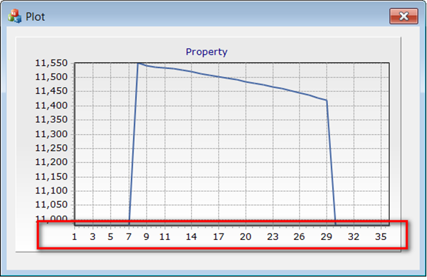

We are using .net tee chart version 2012. While plotting the chart, we are facing an issue related to labels and axis lines for bottom axis. Bottom label are showing with uneven distance as shown in snap shot below (1, 3, 5, 7, 9, 11, 14…….). But the desired output is that the bottom axis should appear with even distance spacing between each label (1, 3,5,7,9,11,13,15 ……). We are using Point Value property for bottom axis labels.
We are sending demo project that reproduce same problem.
Please suggest how we can resolve this issue.

I'm afraid to say that the only way to control the increment of the axes is when the axis labels are set to Auto, e.g.
      Random rnd = new Random();
      Line series = (Line)tChart1.Series.Add(typeof(Line));
      for (int t = 1; t < 20; t++)
        series.Add(t, rnd.Next(0, 10000));
      series.Pointer.Visible = true;
      tChart1.Axes.Bottom.Increment = 2;
      tChart1.Axes.Bottom.Labels.Style = AxisLabelStyle.Auto;
