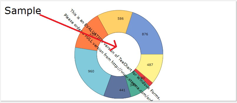

I am sorry , I am not able to position "sample" in center of doughnut
Re: Donut Chart Annotation
Post by Christopher » Wed Aug 24, 2016 1:58 pm
No problem, thank you - you can get this to work with:
      Steema.TeeChart.Tools.Annotation tAnnot = new Annotation(chart);
      tChart1.Tools.Add(tAnnot);
      tAnnot.Text = "Sample";
      tAnnot.Shape.Transparent = true;
      tAnnot.Shape.Font.Size = 25;
      tAnnot.Shape.CustomPosition = true;
      tChart1.Draw();
      tAnnot.Shape.Left = donut1.CircleXCenter - tAnnot.Bounds.Width / 2;
      tAnnot.Shape.Top = donut1.CircleYCenter - tAnnot.Bounds.Height / 2;
      return param;

Post by rpt » Wed Aug 24, 2016 2:42 pm
Thanks this worked. Just want to let you know we are in process of buying .net version of software.
Thanks for your kind support.

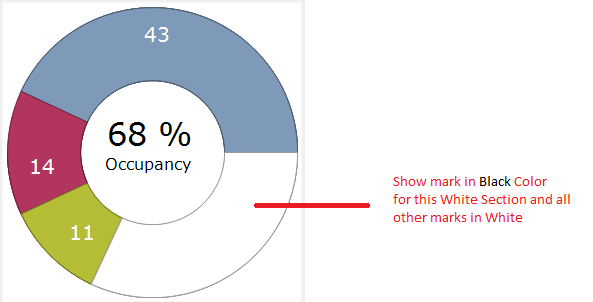

Is this possible to have Marks in different color based on some condition
Posts: 1319
Location: Girona
Post by Marc » Wed Dec 07, 2016 3:48 pm
This would be a way to achieve it:
//add event
donut1.GetSeriesMark += new Steema.TeeChart.Styles.Series.GetSeriesMarkEventHandler(donut1_GetSeriesMark);
private void donut1_GetSeriesMark(Series series, GetSeriesMarkEventArgs e)
      if (e.ValueIndex == 3)   //add your criteria, here 4th point
        series.Marks.Font.Color = Color.White;
        series.Marks.Font.Color = Color.Black;
series.ValueColor(e.ValueIndex) would give you the Point colour if you were to wish to check by that.

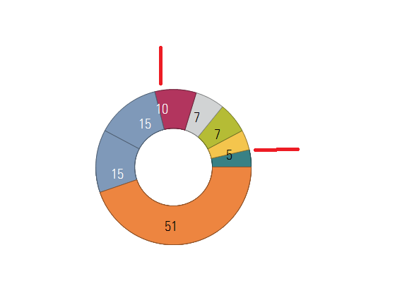

Can you please help me to put marks in center in donut chart.
Source :https://github.com/dekajp/TeeChart-for- ... ms-samples
Post by Christopher » Mon Jan 09, 2017 11:38 am
rpt wrote:Can you please help me to put marks in center in donut chart.
I think you should be able to use the technique for custom positioning of marks which you can see here.
Posts: 1319
Location: Girona
Post by Marc » Tue Jan 10, 2017 3:18 pm
As an alternative approach, you can turn off Marks and plot them yourself to take more control. This code centres them.
Eg.
donut.Marks.Visible = false;
//use Chart’s AfterDraw event
    private void tChart1_AfterDraw(object sender, Steema.TeeChart.Drawing.Graphics3D g)
      Steema.TeeChart.Styles.Donut dnt = (Steema.TeeChart.Styles.Donut)tChart1[0];
      for (int i=0; i < dnt.Count; i++)
        //use these integers for plot coords
        int startxx;
        int startyy;
        int endxx;
        int endyy;
        //outside permiter halfway on each point
        dnt.AngleToPos(dnt.Angles[i].MidAngle, dnt.XRadius, dnt.YRadius, out startxx, out startyy);
        //get halfway as fraction, from donut hole to exterior
        double halfwayloc = 1.0-(1.0 - (dnt.DonutPercent / 100.0)) / 2.0;
        //get centre location for each Mark
        dnt.AngleToPos(dnt.Angles[i].MidAngle, dnt.XRadius * halfwayloc, dnt.YRadius * halfwayloc, out endxx, out endyy);
        //setup Font
        g.Font.Size = 14;
        g.Font.Name = "Microsoft Sans Serif";
        //Get Mark text
        string myText = dnt.ValueMarkText(i);
        //output Text
        g.TextOut(endxx - (int)(g.TextWidth(myText)/2), endyy - (g.FontHeight/2), dnt.ValueMarkText(i));
You could add more sophistication. If the slice is small you could reduce the Font size (eg. if ((dnt.Angles.StartAngle - dnt.Angles.EndAngle) < somevalue) .. make font smaller…)
Or change the colour of the mark if the slice is a dark colour or light, etc.
I hope that may be of help.
