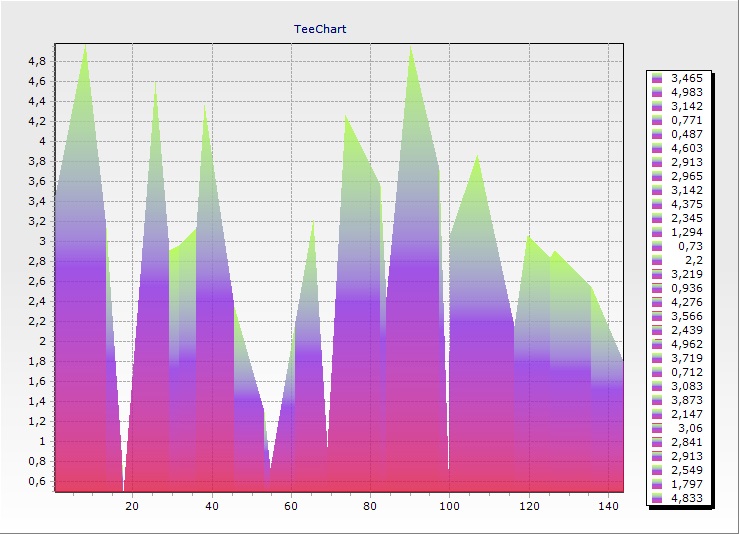

Thanks for reply, the first workaround works. However, I have another problem. When I use transparency and want to hide area lines, 1px-wide gaps appear. Can be reproduced with:
Area area = new Area();
area.Color = Color.GreenYellow;
area.AreaBrush.Gradient.StartColor = Color.GreenYellow;
area.AreaBrush.Gradient.MiddleColor = Color.BlueViolet;
area.AreaBrush.Gradient.EndColor = Color.Crimson;
area.AreaBrush.Gradient.UseMiddle = true;
area.AreaBrush.Gradient.Visible = true;
area.AreaBrush.Gradient.Transparency = 20;
area.AreaLines.Visible = false;
area.FillSampleValues();
chart.Series.Add(area);
This is how it looks:
This only happens if transparency is used. If I set GradientRelative to false, gaps dissapear, but some other problem pops up, so I'd like to avoid it. It worked in 2.0.2652.22325.

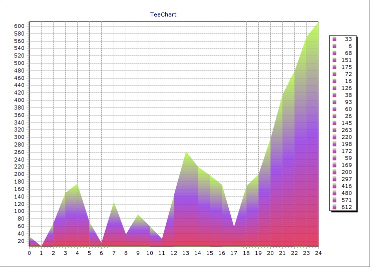

Unfortunately, this doesn't work for me if the data is irregular:
var x = 0d;
for (int i = 0; i < 30; i++)
    x = random.NextDouble()*10 + x;
    var y = random.NextDouble()*5;
    area.Add(x, y);
chart.CurrentTheme = ThemeType.Opera;
This produces:

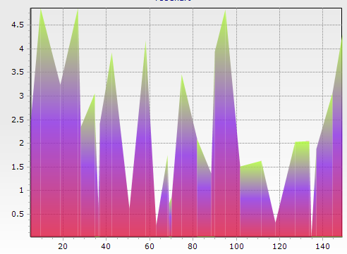

Re: Adding area to chart modifies its StartColor
Post by Christopher » Thu Sep 01, 2016 10:08 am
The answer here is to change the SmoothingMode, e.g.
    Random random = new Random();
      tChart1.CurrentTheme = ThemeType.Opera;
      tChart1.Graphics3D.SmoothingMode = SmoothingMode.HighSpeed;
      area.AreaBrush.Gradient.GammaCorrection = true;
      area.LinePen.Visible = false;
      var x = 0d;
      for (int i = 0; i <= 30; i++)
        x = random.NextDouble() * 10 + x;
        var y = random.NextDouble() * 5;
        area.Add(x, y);
      tChart1.Series.Add(area);
which gives me:

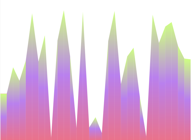

FYI, you can see this effect outside of TeeChart, e.g. in a UserControl:
  public partial class UserControl2 : UserControl
    public UserControl2()
    Random rnd = new Random();
    protected override void OnPaint(PaintEventArgs e)
      Func<Rectangle, Color, Color, Color, LinearGradientBrush> Gradient = (rect, startColor, middleColor, endColor) =>
        LinearGradientBrush result = new LinearGradientBrush(rect, startColor, endColor, LinearGradientMode.Vertical);
        ColorBlend blend = new ColorBlend(3);
        blend.Colors[0] = startColor;
        blend.Colors[1] = middleColor;
        blend.Colors[2] = endColor;
        blend.Positions[0] = 0;
        blend.Positions[1] = 0.5F;
        blend.Positions[2] = 1;
        result.InterpolationColors = blend;
        result.GammaCorrection = false;
        return result;
      Func<Point[], Rectangle> BoundingRect = (p) =>
        Rectangle r = new Rectangle();
        if (p.GetUpperBound(0) > 1)
          r.X = p[0].X;
          r.Width = 0;
          r.Y = p[0].Y;
          r.Height = 0;
          for (int t = 1; t <= p.GetUpperBound(0); t++)
            if (p[t].X < r.Left)
              r.Width = r.Right - p[t].X;
              r.X = p[t].X;
            if (p[t].X > r.Right)
              r.Width = r.Width + p[t].X - r.Right;
            if (p[t].Y < r.Top)
              r.Height = r.Bottom - p[t].Y;
              r.Y = p[t].Y;
            if (p[t].Y > r.Bottom)
              r.Height = r.Height + p[t].Y - r.Bottom;
        return r;
      Graphics g = e.Graphics;
      g.SmoothingMode = SmoothingMode.HighQuality;
      Rectangle bounds = this.Bounds;
      int count = 30;
      int width = bounds.Width / count;
      int trans = (int)Math.Round(255 * 0.6);
      Point oldTopRight = Point.Empty;
      for (int i = 0; i < count; i++)
        int x0 = width * i;
        int y0 = rnd.Next(bounds.Height);
        int x1 = x0 + width;
        int y1 = bounds.Height;
        Point topLeft = new Point(x0, y0);
        Point topRight = new Point(x1, y0);
        Point bottomRight = new Point(x1, y1);
        Point bottomLeft = new Point(x0, y1);
        Point[] poly = new Point[] { oldTopRight == Point.Empty ? topLeft : oldTopRight, topRight, bottomRight, bottomLeft};
        Rectangle rect = new Rectangle(x0, y0, width, bounds.Height - (oldTopRight == Point.Empty ? y0 : Math.Min(oldTopRight.Y, y0)));
        LinearGradientBrush grad = Gradient(BoundingRect(poly), Color.FromArgb(trans, Color.GreenYellow), Color.FromArgb(trans, Color.BlueViolet), Color.FromArgb(trans, Color.Crimson));
        g.FillPolygon(grad, poly);
        oldTopRight = topRight;
use of which gives me:

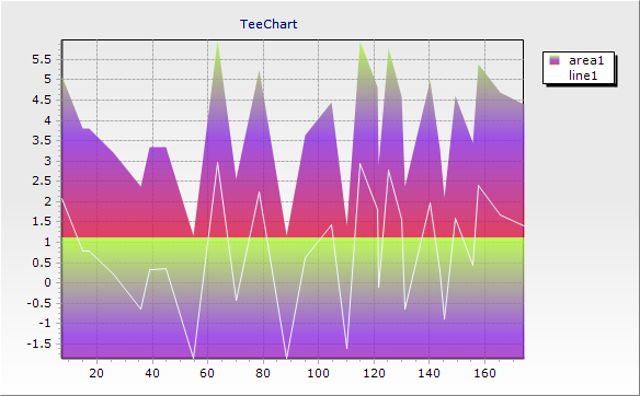

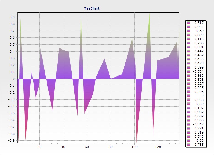

When I used GradientRelative then area's color became solid below y-value of 1. But nevermind, we decided to simply disable area's antialiasing for the time being. Thanks for the assistance.

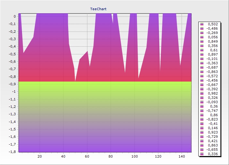

Post by Christopher » Wed Sep 07, 2016 8:42 am
Using the following code:
      area.GradientRelative = false;
      area.Origin = 0;
      area.UseOrigin = true;
      var x = 0d;
        double y = random.NextDouble();
        bool flag = random.NextDouble() < 0.5;
        y = flag ? y : y * -1;
        area.Add(x, y);
I get this chart:
Is this not what you expect?
Matis
Posts: 7
Joined: Tue Aug 16, 2016 12:00 am
Post by Matis » Thu Sep 08, 2016 8:15 am
I reproduced the problem in a sample app. It's not actually below 1 and not solid color (that was true for the data and settings in my actual application), but rather a "restarted" gradient below lowest y-value of an area. It happens when there are more multiple series. It looks like a rectangle is drawn below an area chart and its gradient is drawn separately from area above it:
            var data = GetData();
            area.Color = StartColor;
            SetData(area, data);
            Line line = new Line();
            line.Color = Color.AliceBlue;
            var newData = data.Select(p => new Point(p.X, p.Y - 3));
            SetData(line, newData);
            chart.Series.Add(line);
Post by Christopher » Thu Sep 08, 2016 9:12 am
Okay, thank you, I think I can see what's happening - if I use this code:
        area.Add(x, y);
and then use the mouse to scroll the chart upwards, I get this:
I have added this to our issue tracker with id=1625.
