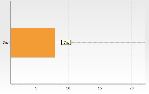

We want to create Tornado plot For that we are using horizontal Bar. We are facing a issue that the bar is always starting from axis origin as shown in image below:
img 1
in this we have given value:
horizbar.Add(8,"Dip");
so it is drawing like the above img.

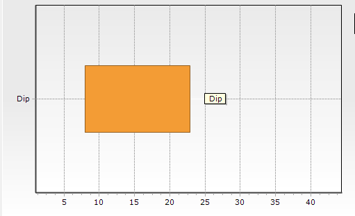

But we want something like the below image:
So here we want that our bar should draw between value 8 to 23 as shown in above image.
Means we do not want to draw bar from axis scale or from origin.
please provide any solution asap.

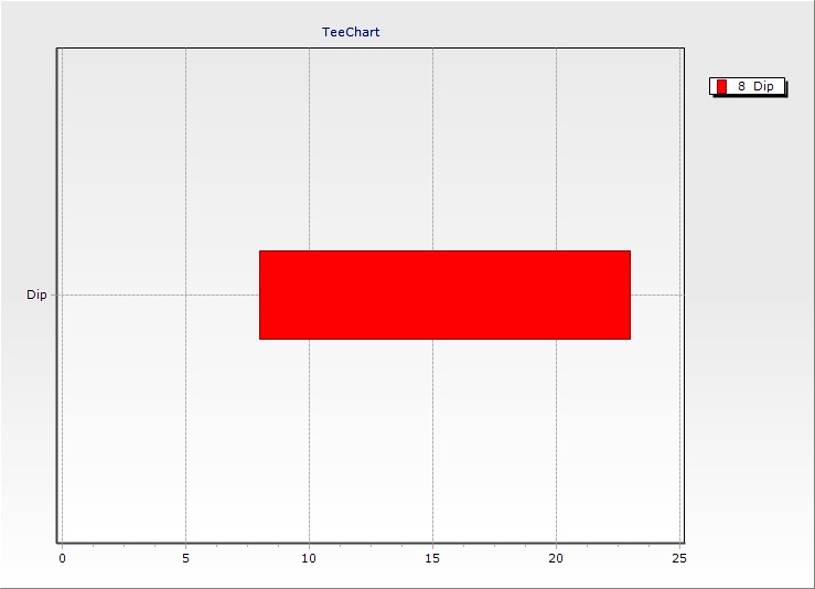

You could try using a Gantt series, e.g.
    Gantt series;
      series = new Gantt(tChart1.Chart);
      series.Add(8, 23, 0, "Dip", Color.Red);
      series.Pointer.VertSize = 40;
      series.XValues.DateTime = false;
      tChart1.Axes.Bottom.SetMinMax(0, 25);
which gives this:

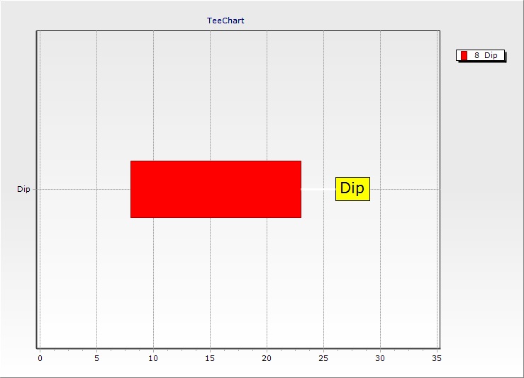

As you already know, it is possible to draw custom elements onto the chart. If you wish full control over the series marks, you could simply draw your own e.g.
    Gantt series;
      tChart1.Axes.Bottom.SetMinMax(0, 35);
      tChart1.AfterDraw += TChart1_AfterDraw;
    private void TChart1_AfterDraw(object sender, Graphics3D g)
      Action DrawMarks = () =>
        for (int i = 0; i < series.Count; i++)
          g.Font.Size = 16;
          string text = series.Labels[i];
          int buffer = 5;
          int height = (int)Math.Ceiling(g.TextHeight(text)) + buffer;
          int width = (int)Math.Ceiling(g.TextWidth(text)) + buffer;
          int xPos = series.CalcXPosValue(series.EndValues[i]) + width;
          int yPos = series.CalcYPos(i) - (height / 2);
          Rectangle rect = Utils.FromLTRB(xPos, yPos, xPos + width, yPos + height);
          g.Brush.Color = Color.Yellow;
          g.Rectangle(rect);
          g.TextOut(rect.X + (buffer / 2), rect.Y + (buffer / 2), text);
          g.Pen.Color = Color.White;
          g.Pen.Width = 3;
          g.HorizontalLine(xPos - width, xPos, yPos + (height / 2));
      DrawMarks();
