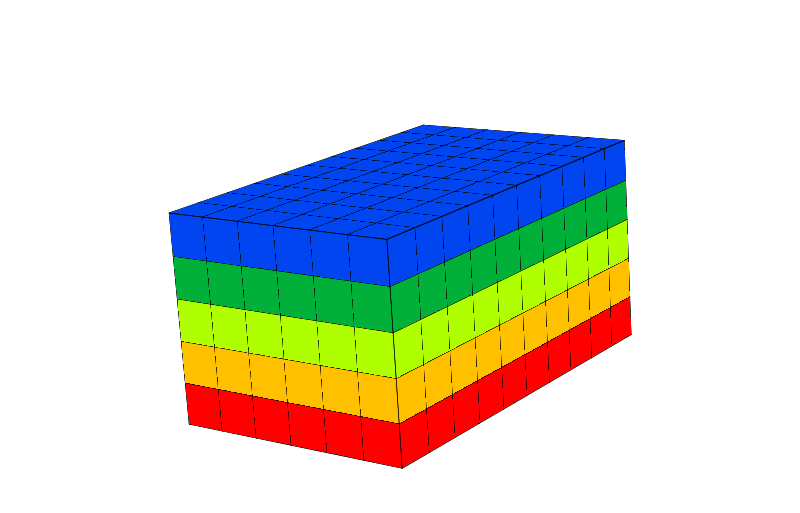

We want to draw curve like below image
It contains five layers as shown in different color.
Planoresearch
Re: 3D grid
Post by Christopher » Mon Oct 03, 2016 9:42 am
Many apologies for the delay in replying to your question. You could use the Tower Series, e.g.
      for (int i = 0; i < 5; i++)
        Tower s = (Tower)tChart1.Series.Add(typeof(Tower));
        s.UseColorRange = false;
        s.UsePalette = false;
        s.UseOrigin = true;
        s.Origin = i;
        s.Stacked = true;
      tChart1[0].Color = Color.Red;
      tChart1[1].Color = Color.Orange;
      tChart1[2].Color = Color.LightGreen;
      tChart1[3].Color = Color.Green;
      tChart1[4].Color = Color.Blue;
      for (int x = 0; x < 10; x++)
        for (int z = 0; z < 10; z++)
          for (int i = 0; i < tChart1.Series.Count; i++)
            ((Tower)tChart1[i]).Add(x, 1, z);
      tChart1.Tools.Add(typeof(Rotate));
which can give you:
