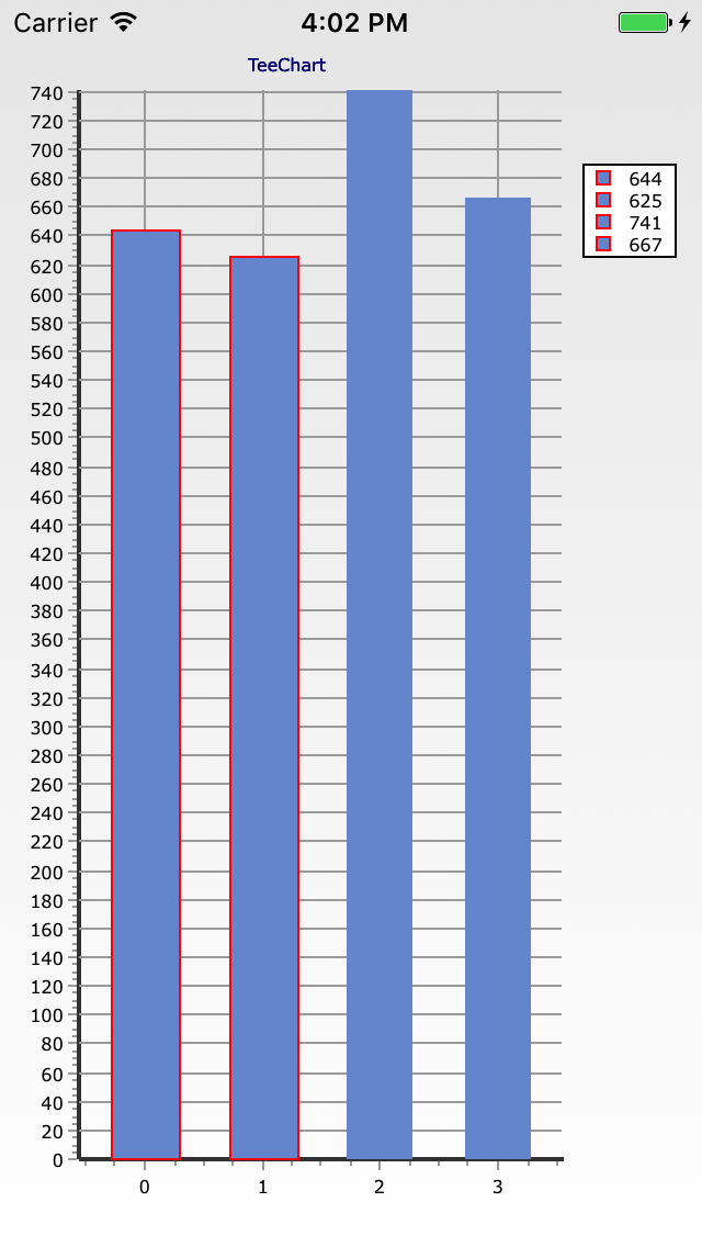

I get the following result :
Please, send me an example image, or explain in more detail what're you trying to accomplish.
