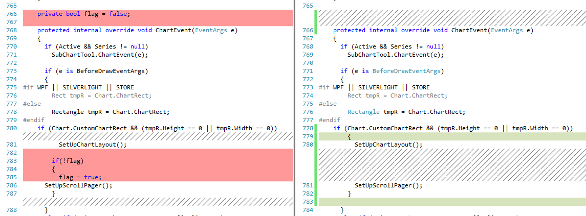

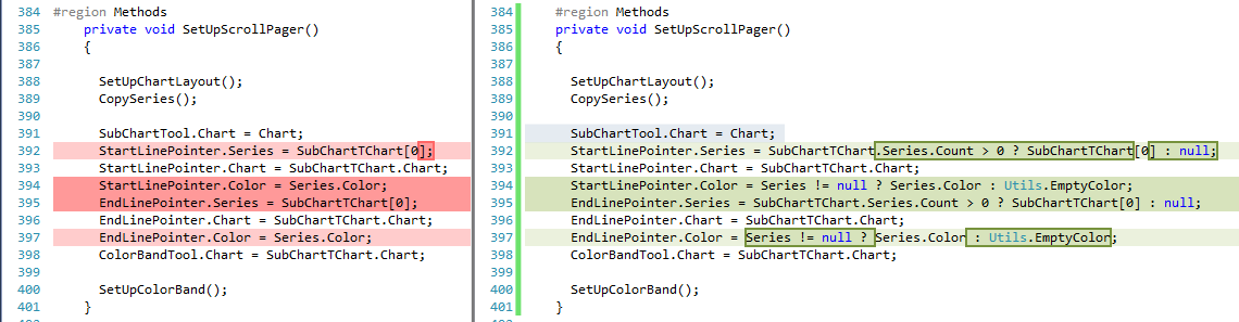

If you have the source code, within the ScrollPager.cs unit you can make these changes:
these should fix the designtime issues for you.

I've made a number of changes to ScrollPager.cs, and although changing the boundaries with the mouse at designtime as one can at runtime is not possible (the boundaries can be changed using the Chart Editor, however), changes at designtime are now more accurately reflected at runtime. Possibly the easiest way to get these changes to you is by email - if you could give me your email I can sent this modified unit to you.
