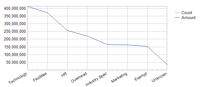

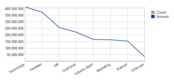

I start with a chart created with multiple Line series. The chart looks like:
if I turn on the 3D setting I get:

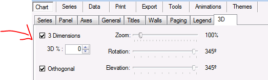

The easiest way to duplicate this is to click the 3 Dimensions check box if tools is open:
What I click.PNG (8.25 KiB) Viewed 9688 times

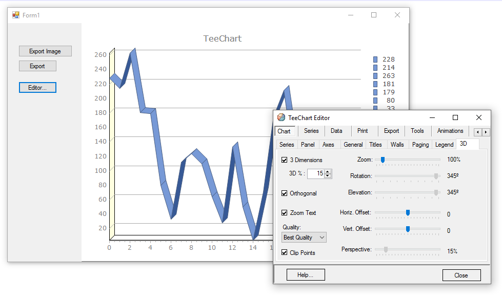

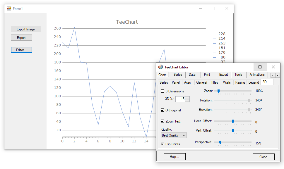

1) I want the boxes when 3D is turned off. The Legend lines in 2D mode are just too small for the user to sometimes tell the differences in the color. I have tried to change the Legend symbol and other things but nothing seems to work.
2) Why cannot I have the lines which are in 2D mode when 3D is turned on? The lines in 3D mode are really thick.
3) How do I get the "thick" lines in 2d mode?

This is what I get with this code:
			tChart1.ShowEditor();
			Line series = new Line(tChart1.Chart);
			series.FillSampleValues();
firstly:
then having activated 3D:
do you get the same with this code? If so, could you please modify it so I can reproduce your issue here?

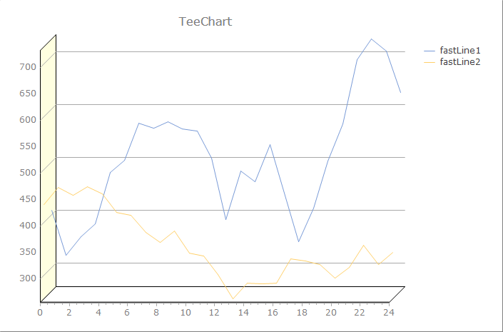

biqpaulson wrote: 2) Why cannot I have the lines which are in 2D mode when 3D is turned on? The lines in 3D mode are really thick.
You could try using the FastLine series instead of the Line series, which would give you:
			tChart1.Aspect.View3D = true;
			FastLine series = new FastLine(tChart1.Chart);
			FastLine series1 = new FastLine(tChart1.Chart);
			series1.FillSampleValues();

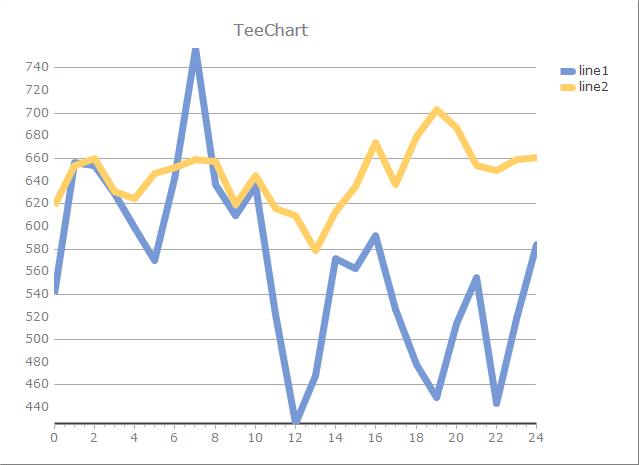

biqpaulson wrote: 3) How do I get the "thick" lines in 2d mode?
The closest might be something like this:
			Line series1 = new Line(tChart1.Chart);
			series.LinePen.Width = 7;
			series.LinePen.EndCap = System.Drawing.Drawing2D.LineCap.Round;
			series1.LinePen.Width = 7;
			series1.LinePen.EndCap = System.Drawing.Drawing2D.LineCap.Round;
