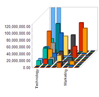

There seems to be a problem with label minimum separation when the label is not at an exact 90 or 180 degree increment.
This first example is when the labels on the bottom axis are at 90 degrees with a 1 percent minimum separation:
Min separation 1 percent - 90 degrees.PNG (14.7 KiB) Viewed 19999 times

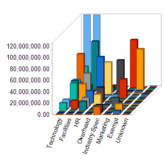

If the angle is changed by only one degree, on the next picture it is 89 degrees, the label separation is not by one percent separation but much much more:
Min separation 1 percent - 89 degrees.PNG (13.46 KiB) Viewed 20000 times

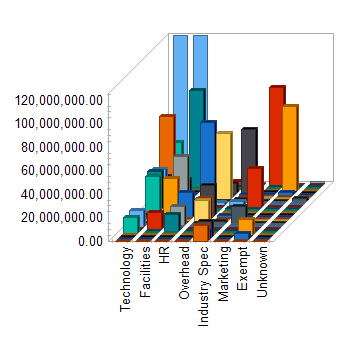

Now this can be sort of fixed by making the minimum separation a value of zero percent as in this example where the angle is increased to 70 degrees with no problem:
Min separation 0 percent - 70 degrees.PNG (16.06 KiB) Viewed 19992 times
Of course, with zero percent labels sometimes overlap and hence look horrible if the user resizes the form to a smaller size.
Is there a way to know when labels overlap and exclude them when the minimum separation is zero or is there a way to fix the one percent (or any percent value) separation so that it works appropriately when the angles are at a value of anything other than 90 and 180 degrees?

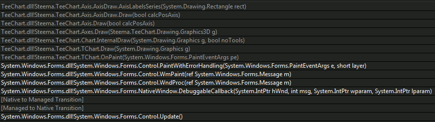

The stack trace is in the picture below:
Spinning in GetAxisSeriesLabel.PNG (21.47 KiB) Viewed 19947 times
