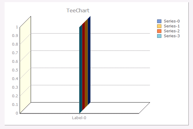

I have a problem with bars in multiple series bar charts where each series has only one point in them.

If NUMBER_OF_POINTS is set to 2 then you get:
If NUMBER_OF_POINTS is set to 1 then you get:
This is using the "Steema TeeChart for .NET 2016 4.1.2016.10260" of the library.
The "Steema TeeChart for .NET 2016 4.1.2016.05120" version of the library does not have this problem.

Unfortunately a similar issue has already been reported and fixed in id=1794. In the meantime, you should be able to set the CustomBarWidth to ameliorate the rendering in these particular cases:

        TheSeries.CustomBarWidth = 150;
