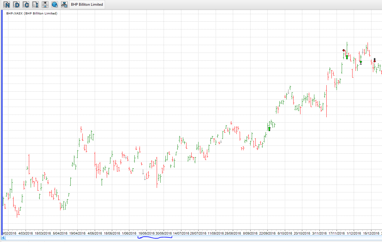

Figure 1: Using the TeeChart theme gives me this screen. A uneven spacing of vertical grid lines. Note that I had to set the ChartAxis.Grid.DrawEvery = 1; in ThemeProperties.ChangeAxis(Axis ChartAxis) for bottom axis because for some reason it is set to 2 and what it does is skip 1 line which is not what we want.
Figure 1

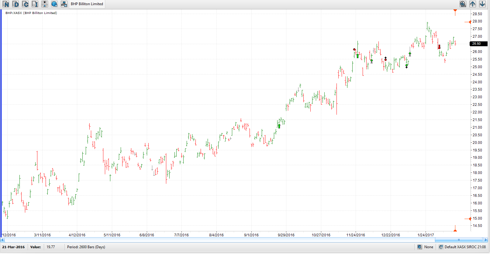

Figure 2: It seems that commenting this code ThemeProperties.Instance.AxisLabelsFontSize = 8; from TeeChartThemes.SetDefaultValues() fixes the problem but the spacing is too wide compared to what we currently have.
Figure 2

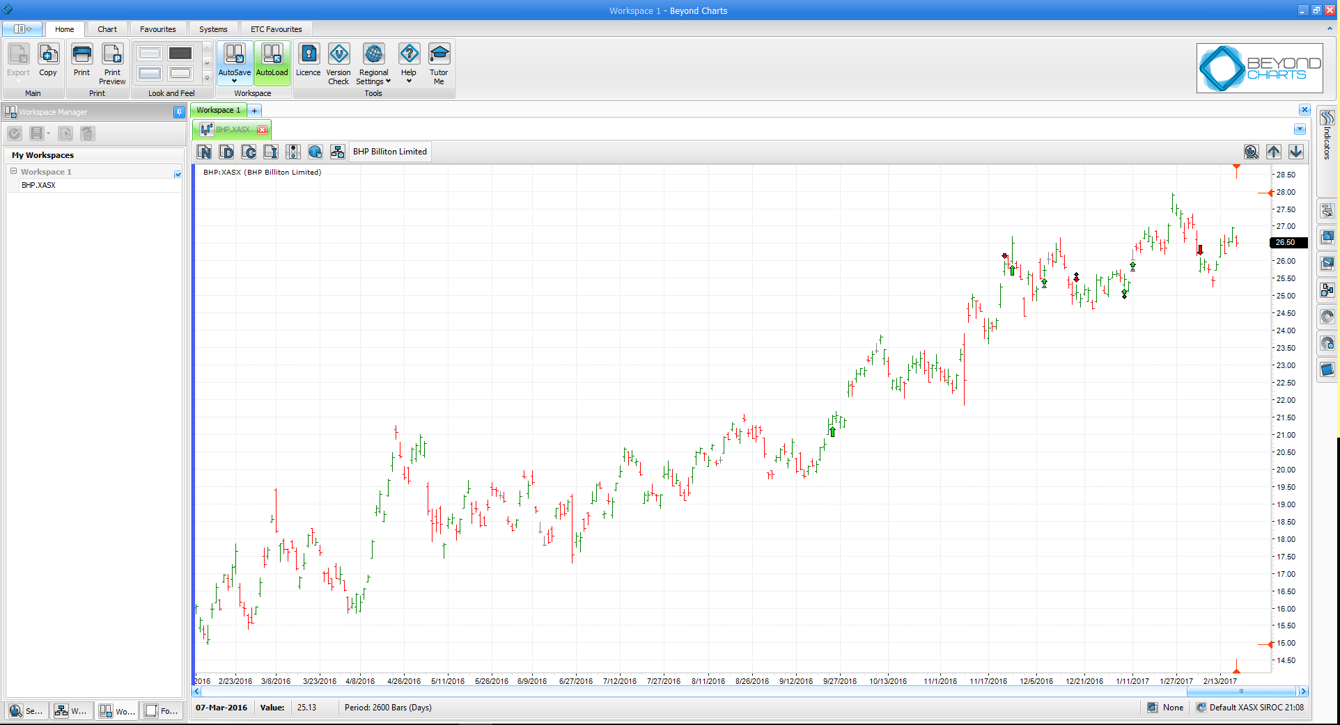

Figure 3: Is what our current app looks like with the old version of TeeChart.
Figure 3

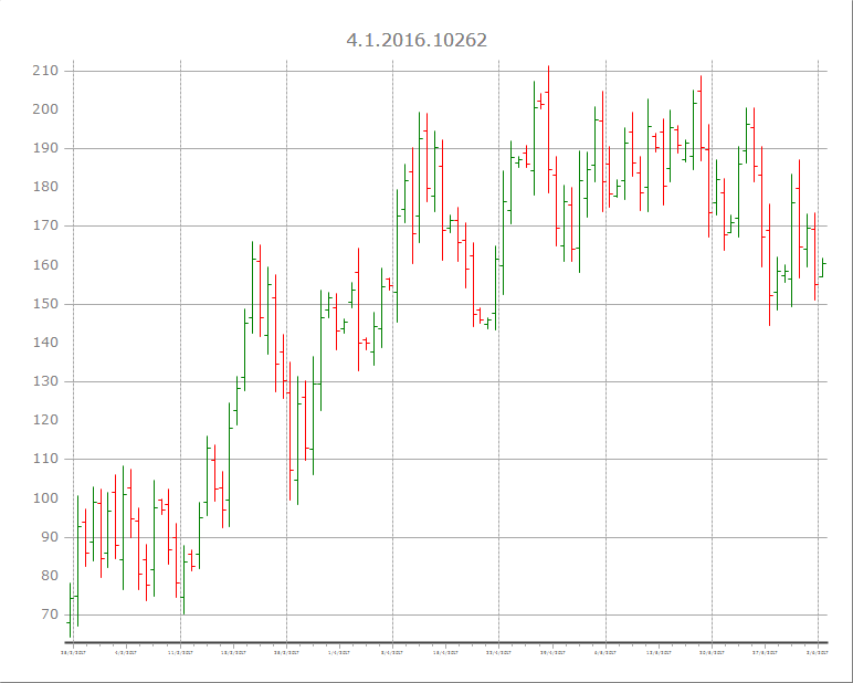

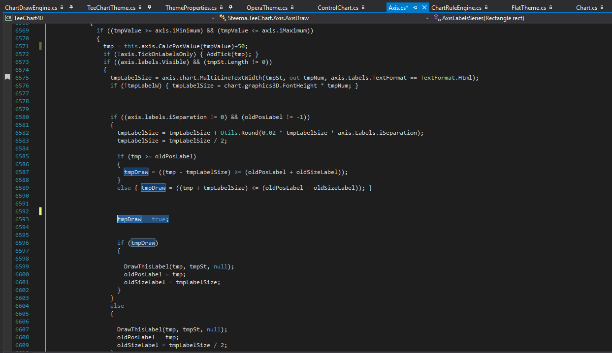

After a digging through the code, I noticed that there is a logic that skips a line when the label is too wide which I think is there to avoid overlapping dates. I found it in Axes.AxisLabelsSeries(Rectangle rect)
where tmpDraw will be false if it thinks the date will overlap. I fixed this to always true and I got the result that I needed except that its a bit cramped..
This is the code where I force tmpDraw = true

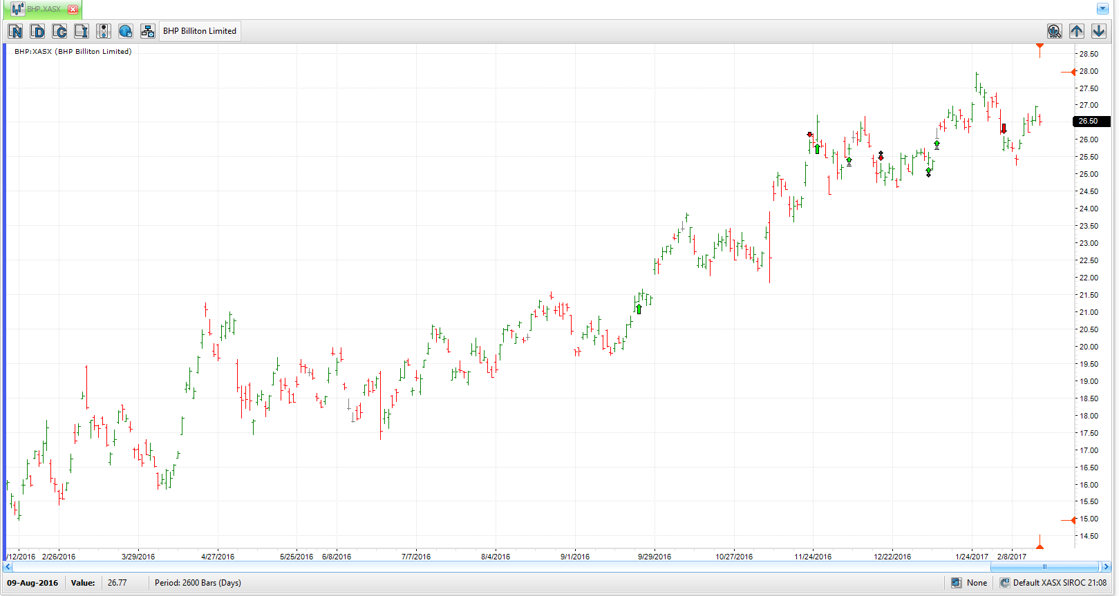

Figure 1
And this is what I got
Figure 2
Next question is, how to I set the width of the grid to make it a few pixels wider so the date text wont be too close to each other?

Post by Christopher » Tue Feb 28, 2017 10:10 am
sharewealth wrote: Next question is, how to I set the width of the grid to make it a few pixels wider so the date text wont be too close to each other?
It would be useful, if only to ascertain we are both running a binary which gives us the same result, if you could run the following code and post a screencap of the result you obtain:
          CreateChart();
        TChart tChart1;
        private void CreateChart()
          tChart1 = new TChart();
          splitContainer1.Panel2.Controls.Add(tChart1);
          Candle series = new Candle(tChart1.Chart);
          series.FillSampleValues(100);
          series.UpCloseColor = Color.Green;
          series.Style = CandleStyles.CandleBar;
          tChart1.Axes.Bottom.Grid.Visible = true;
          tChart1.Axes.Bottom.Labels.Font.Size = 3;
          tChart1.Header.Text = Utils.Version;
          tChart1.Export.Image.PNG.Save(@"D:\FTP\" + "TChart" + DateTime.UtcNow.Ticks.ToString() + ".png");
If this code works for you as it works here, I believe it should be somewhat easier for me to help you resolve your issue.
