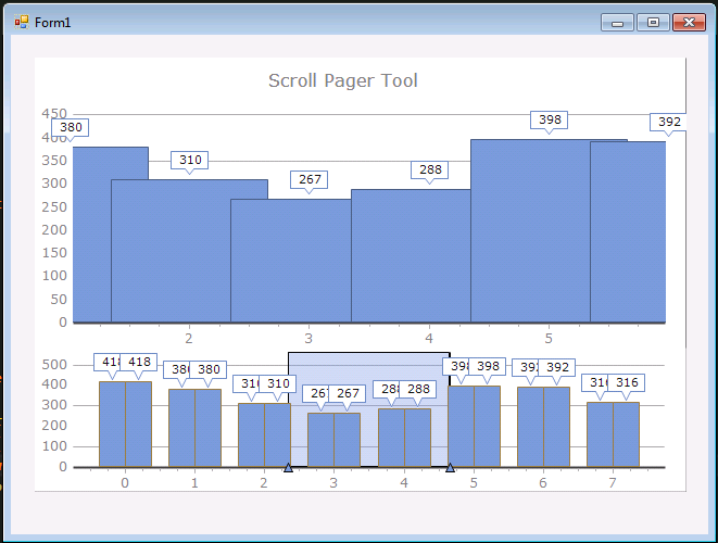

I am using a ScrollPager and for some reason for Bar and HorizBar the tool is not working correctly.
1) the bars in the top chart overlap.
2) the bars in the bottom are doubled.
The code I used is:
using Steema.TeeChart;
using Steema.TeeChart.Styles;
using Steema.TeeChart.Tools;
using System;
using System.ComponentModel;
using System.Data;
using System.Drawing;
using System.Linq;
using System.Text;
using System.Threading.Tasks;
using System.Windows.Forms;
namespace ScrollPagerTest
            AddPagerTool();
        ScrollPager tool;
        Steema.TeeChart.Styles.Bar series;
            tChart1.Header.Text = "Scroll Pager Tool";
            tChart1.Series.Add(series = new Steema.TeeChart.Styles.Bar());
            series.FillSampleValues(8);
            series.Legend.Visible = false;
        private void AddPagerTool()
            tChart1.Tools.Add(tool = new ScrollPager());
            tool.Series = series;
            tool.SubChartTChart.Panel.Pen.Visible = false;
            tool.SubChartTChart.Panel.Bevel.Inner = Steema.TeeChart.Drawing.BevelStyles.None;
            tool.SubChartTChart.Panel.Bevel.Outer = Steema.TeeChart.Drawing.BevelStyles.None;
The picture showing this is:
overlap and doubled.PNG (24.53 KiB) Viewed 6511 times
Is there a way to fix this?

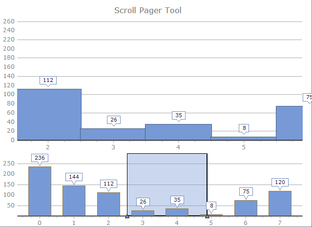

I have added this issue to our issue-tracker with id=1809 - as you will be able to read, this issue is not reproducible in the latest sources and renders like this:
The latest sources will soon be built and made public in the upcoming maintenance release.
