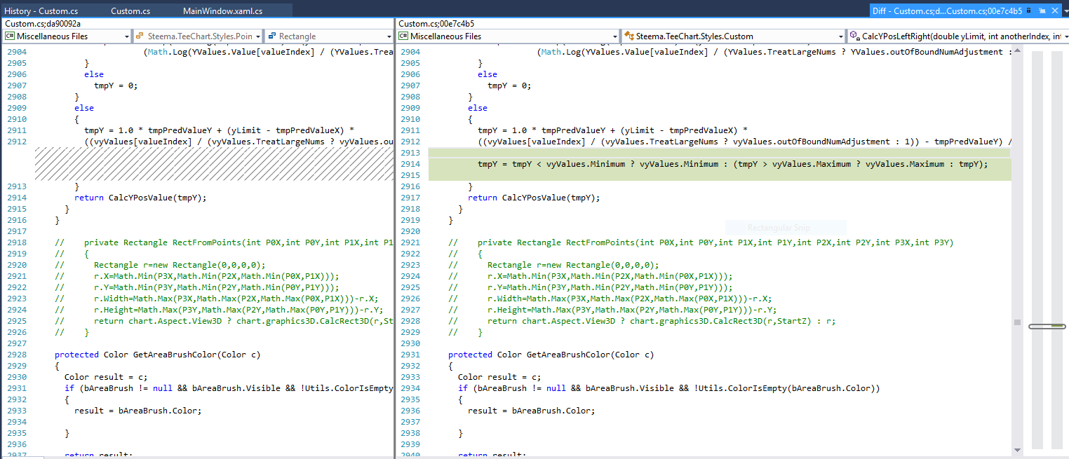

Great - in which case the change is a one-liner in Custom.cs:

Post by Siva » Thu May 04, 2017 10:44 am
Hi Chris,
I made the changes specified and it does not solve the problem. Use the attached modified sample.
While loading I'm adding points between 20 and 50. After this I'm adding one more point between 20 and 80 every second. Now again there is a line at extreme left where the line touches 80 even though I didn't add a point with that value.
