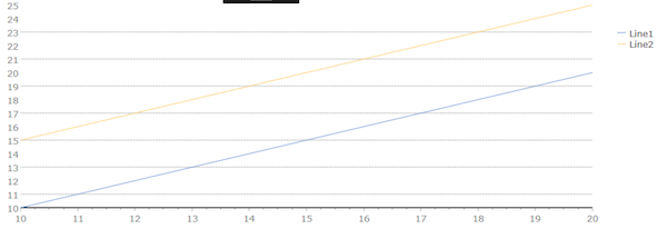

Steema.TeeChart.WPF.Styles.Line line = new Steema.TeeChart.WPF.Styles.Line(TeeChart) {
	Title = "Line1"
line.Add(10, 10);
line.Add(20, 20);
Steema.TeeChart.WPF.Styles.Line line2 = new Steema.TeeChart.WPF.Styles.Line(TeeChart) {
          Title = "Line2"
line2.Add(10, 15);
line2.Add(20, 25);
스크린샷 2017-04-21 오전 12.21.45.png (37.51 KiB) Viewed 6387 times

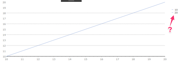

It works fine. but single series line char legend is something wrong.
	Title = "Line1"
line.Add(10, 10);
line.Add(20, 20);
스크린샷 2017-04-21 오전 12.26.54.png (32.85 KiB) Viewed 6389 times

Post by Christopher » Thu Apr 20, 2017 9:54 pm
You can use the LegendStyle to control what appears in the Legend, e.g.
      Line line = new Line(tChart1.Chart);
      line.Add(10);
      line.Add(20);
      tChart1.Legend.LegendStyle = LegendStyles.Series;
