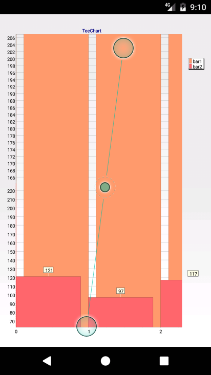

Firstly, I would like inform you that if you add a custom axis is needed assign it to a series. I have modified the code you sent us because it works properly with custom axes and seems zoom works fine as is shown in image below:

I have checked the modified project, it works after assigning the custom vertical axis to a series.
