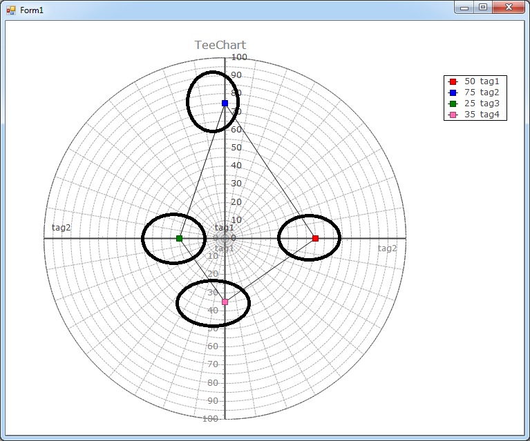

In 4.1.2015.8062 I could use ColorEach for setting different color on each data point in an PolarSerie.
After upgrading to 4.1.2017.10193 all the Point have the same color.
In the attachment is sample code and two Pictures.
Picture1.jpg shows output with version 4.1.2015.8062
and
Picture2.jpg shows output with version 4.1.2017.10193
polartest.zip
sample code
(258.72 KiB) Downloaded 765 times

Hello Tomas,
Tomas wrote: After upgrading to 4.1.2017.10193 all the Point have the same color.
I have been able to reproduce this problem here. Unfortunately it is a regression introduced by the fix to issue id=1451 in v.4.1.2016.05120 (released on 12th May 2016). I have added this regression to our issue-tracker with id=2012 - as you can see in that ticket, the issue has been fixed and there is an easy workaround you can use in the meantime until the next release becomes avaialble.
Many apologies for any inconvience caused by this.
