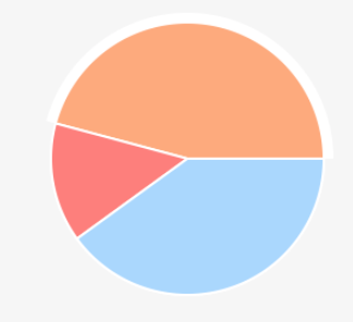

Having some trouble searching through the examples and the documentation on how to create following pie chart.
DesignVersion
Screen Shot 2018-04-19 at 11.07.12.png (20.51 KiB) Viewed 26553 times

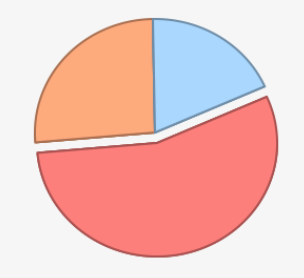

With some trail and error I got following result
SteemaVersion
Screen Shot 2018-04-19 at 11.06.47.png (25.94 KiB) Viewed 26553 times

1. What ( and how ) is the best solution to have each slice exploded ( so not only the biggest )? I did pie.ExplodedSlice.Add(...) for each slice but this seems to have no effect...
2. Current version has a fine border around each slice, how can I get rid of this? Or can this also be used to fix 1.? If I can make it wider and white?

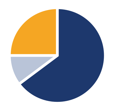

Hey Sandra,
Thanks for the reply!
Trying out the Pen color and width settings, but somehow the pen width is only applied to 1 of the slices and only the outerbound?
SteemaVersion
Screen Shot 2018-04-20 at 14.21.08.png (20.43 KiB) Viewed 26544 times

Post by Sandra » Tue Apr 24, 2018 11:31 am
Hello Bank Van Breda,
Sorry for the delay.
I would like inform you we have reproduced and fixed the Pie.Pen Size problem. Tomorrow, we add a new Steema.TeeChart.NET.STD.Xamarin.Forms maintenance release in the Nuget where the fix is included.
