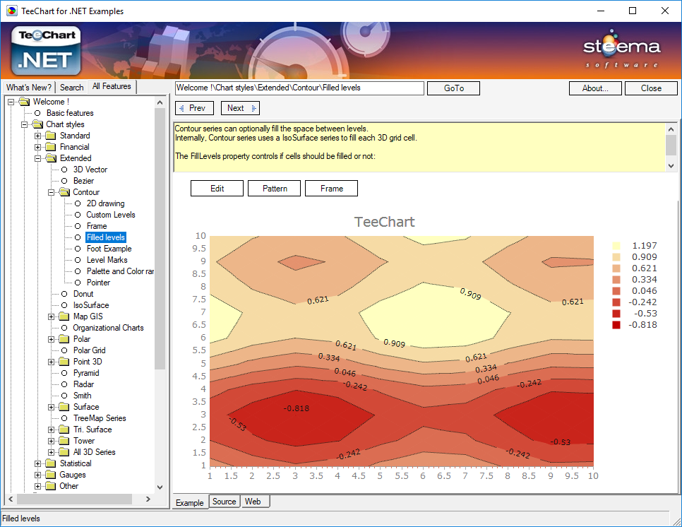

have you had a look at the Contour series? There are several demos in the Feature Demo:

But in "Filled Levels" example contrours setting color like this-
this.contour1.Brush.Color = System.Drawing.Color.FromArgb(((int)(((byte)(68)))), ((int)(((byte)(102)))), ((int)(((byte)(163)))));
this.contour1.EndColor = System.Drawing.Color.FromArgb(((int)(((byte)(192)))), ((int)(((byte)(0)))), ((int)(((byte)(0)))));
this.contour1.FillLevels = true;
this.contour1.StartColor = System.Drawing.Color.FromArgb(((int)(((byte)(255)))), ((int)(((byte)(255)))), ((int)(((byte)(192)))));
but actually tchart plot in diffrent way...why?
In start color chart setting light yellow color.
In End color chart setting dark brown color.(I am relating with as we set gradient color).
Query1. But chart showing many colors, i am unable to understand this.
Query2. One more thing sir please explains steps in contour and logic behind drawing of contour means how we draw contour without using fillsamplevalues method.
Query3. Please provide dummy data for drawing contours in teechart.

amol wrote: Query1. But chart showing many colors, i am unable to understand this.
Okay - the problem is also that I may have misunderstood your requirements.

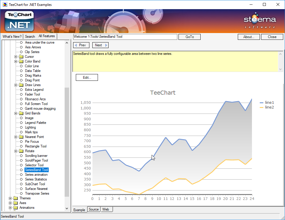

In which case, have you considered the SeriesBand tool?
you could add several of these between each of your line series.

Actually we have data for X,Y,Z and want to draw with contour series and the view mode 3D is false.
We can not use line series here.
So please provide solution for below queries-

Over and above the ColorGrid/Contour series examples in the Feature Demo, I think the best place to look for further examples of how to use these series is in these forums - could I please suggest you search these forums and have a look at the examples other clients have given us?
e.g. ColorGrid -> here.
Contour -> here
