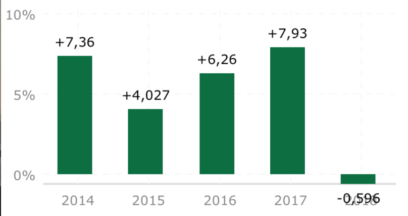

How do we compensate for the space needed to show negative bar marks?
Cfr screenshot
Screen Shot 2018-05-04 at 14.17.54.png (50.24 KiB) Viewed 34224 times
The last bar has a negative value and now masks the bottom axes value. Can we fix this with some offset and if yes how do we calculate that margin?
Side question, can we manipulate the position of the bar marks? So that they will always be above the bar instead of following the value and be below the bar for negative values?

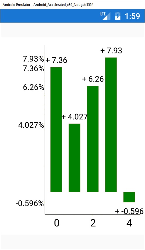

Post by Sandra » Mon May 07, 2018 2:30 pm
Hello Bank Van Breda,
The problem you're experiencing doesn't appear for us using the code below and latest TeeChart for Xamarin.Forms build 4.2018.4.26.

You can show the results I have gotten below:
Could you confirm us you're using latest Teechart for Xamarin.Forms version?

Indeed in a test app with given example code this works fine!
In our production app, not. So I'm trying to rework the example app to see if I can spot the difference. :)
Bank Van Breda
Posts: 22
Joined: Tue Aug 08, 2017 12:00 am
Re: Bar chart - negative values versus bottom axes
Post by Bank Van Breda » Tue May 08, 2018 3:12 pm
Found it... we manipulate left Max value mark
BarChart.Chart.Axes.Left.MaximumOffset = 5;
BarChart.Chart.Axes.Left.AutomaticMaximum = false;
BarChart.Chart.Axes.Left.Maximum = maxValue;
And that MaximumOffset is not needed!
Sorry, our bad ;)
