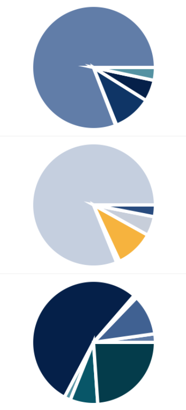

Any reason why the slice center points are not stopping in the center of the pie chart?
The values for the middle one are these by the way
pieData.Data.Add(new GraphData() { Value = 81, Color = Color.FromHex("#B9C4D8") });
pieData.Data.Add(new GraphData() { Value = 1, Color = Color.FromHex("#1D386D") });
pieData.Data.Add(new GraphData() { Value = 10, Color = Color.FromHex("#F5A623") });
pieData.Data.Add(new GraphData() { Value = 5, Color = Color.FromHex("#BBC3D3") });
pieData.Data.Add(new GraphData() { Value = 3, Color = Color.FromHex("#1D386D") });

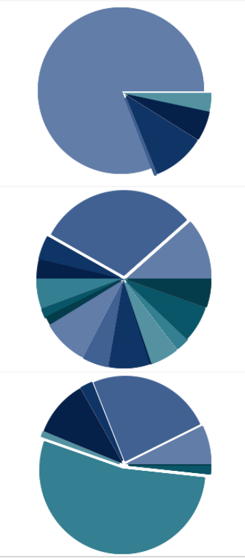

I guess I'll wait for the bug fix... because setting each slice as exploded with value 5 has following visual effect.

We have published a new TeeChart.Net for Xamarin.Froms maintenance release where the bug id2033 is fixed. You can download it from Client Download page

Thanks for the great support! Now works as expected :)
