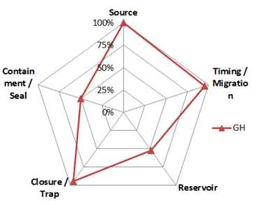

Hi Steema Team,
Can you please send an example for Radar chart in c# silverlight.
I am not able to generate it.
I wanted to create a radar chart like below image.

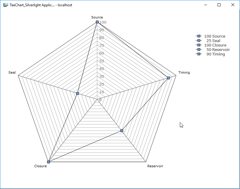

Re: Radar chart
Post by Christopher » Mon May 28, 2018 10:18 am
Hello!
The following code:
		public MainPage()
			tChart1.Header.Visible = false;
			tChart1.Aspect.ClipPoints = false;
			Radar series = new Radar(tChart1.Chart);
			series.Add(100, "Source");
			series.Add(25, "Seal");
			series.Add(100, "Closure");
			series.Add(50, "Reservoir");
			series.Add(90, "Timing");
			series.GetVertAxis.SetMinMax(0, 100);
			series.CircleLabels = true;
			series.Brush.Visible = false;
gives me this:

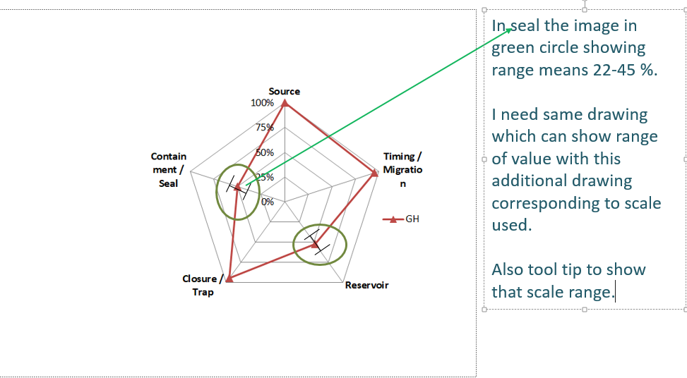

Hi Steema Team,
Thanks for the solution. I need some more help.
I need to show the min and max range for some values. see in below image
In this black line cutting the axis is showing min and max for seal and reservoir .
I need same.Please help me in this.

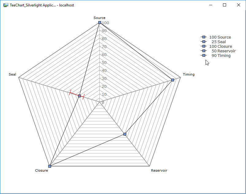

Re: Radar chart
Post by Christopher » Wed May 30, 2018 9:49 am
Hello Amol,
just to remind you that you can use the TeeChart Draw events to draw anything you like on your charts:
so in the case of the Radar series you can do something like this:
using the following code:
		Radar series;
		public MainPage()
			tChart1.AfterDraw += TChart1_AfterDraw;
		private void TChart1_AfterDraw(object sender, Steema.TeeChart.Silverlight.Drawing.Graphics3D g)
			Point center = new Point(series.CalcXPos(1), series.CalcYPos(1));
			Rect rect = Utils.FromLTRB(center.X - 20, center.Y - 10, center.X + 20, center.Y + 10);
			g.Pen.Color = Colors.Red;
			g.HorizontalLine(rect.Left, rect.Right, center.Y);
			g.VerticalLine(rect.Left, rect.Top, rect.Bottom);
			g.VerticalLine(rect.Right, rect.Top, rect.Bottom);

Hi Steema Team,
I need to draw red marked image but in range using scale of axis and it should correspondent to scale.
For example in below image.
Also i need a tool tip to show the data of additional draw image. like in above image.
Amol

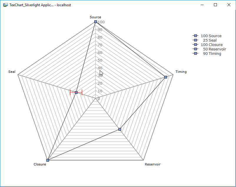

Re: Radar chart
Post by Christopher » Thu Jun 07, 2018 1:00 pm
Okay, the solution to this one is a little complicated and involves extracting a little of the TChart source-code - but it is possible, as you can see here:
		Radar series;
		public MainPage()
		private void CalcXYPos(double xvalue, double yvalue, double aRadius, Axis axis, out double x, out double y)
			double tmp = axis.Maximum - axis.Minimum;
			double tmpDif = axis.Inverted ? axis.Maximum - yvalue : yvalue - axis.Minimum;
			bool tmpAtEnd = tmpDif < 0;
			if ((tmp == 0) || tmpAtEnd)
				x = series.CircleXCenter;
				y = series.CircleYCenter;
				double tmpRadius = tmpDif * aRadius / tmp;
				series.AngleToPos((series.ClockWiseLabels ? -Utils.PiStep : Utils.PiStep) * xvalue, tmpRadius, tmpRadius, out x, out y);
			Func<Point, Point, Tuple<double, double>> CalculateLine = (first, second) =>
				//y − y1 = m(x − x1)
				double m = (first.Y - second.Y) / (first.X - second.X);
				//y = mx + b
				double b = (m * (-1 * second.X)) + second.Y;
				return new Tuple<double, double>(m, b);
			Func<Tuple<double, double>, Point, Tuple<double, double>> CalculatePerpendicularLine = (aline, apoint) =>
				double m = Math.Pow(aline.Item1, -1) * -1;
				double b = (m * (-1 * apoint.X)) + apoint.Y;
			Func<int, double> GetXValue = (valueIndex) =>
				Func<int> GetMaxValuesCount = () =>
					int result = 0;
					bool FirstTime = true;
					foreach (Series s in tChart1.Series)
						if (s.Active && (FirstTime || ((s.Count > result) && s.Function == null)))
							result = s.Count;
							FirstTime = false;
					return result;
				int tmpIndex = series.ClockWiseLabels ? series.Count - valueIndex : valueIndex;
				return (GetMaxValuesCount() > 0) ? tmpIndex * (360.0 / GetMaxValuesCount()) : 0;
			int index = 1;
			Point center = new Point(series.CalcXPos(index), series.CalcYPos(index));
			double plusValue = series.YValues[index] + (series.YValues[index] * 0.45); //45% of value
			double minusValue = series.YValues[index] - (series.YValues[index] * 0.22); //22% of value
			double x, y;
			CalcXYPos(GetXValue(index), plusValue, series.XRadius, series.GetVertAxis, out x, out y);
			Point max = new Point(x, y);
			CalcXYPos(GetXValue(index), minusValue, series.XRadius, series.GetVertAxis, out x, out y);
			Point min = new Point(x, y);
			g.Line(center, max);
			g.Line(center, min);
			Tuple<double, double> line = CalculateLine(min, max);
			Tuple<double, double> maxline = CalculatePerpendicularLine(line, max);
			Tuple<double, double> minline = CalculatePerpendicularLine(line, min);
			//draw whiskers
			int offset = 3;
			g.Line(max, new Point(max.X + offset, (max.X + offset) * maxline.Item1 + maxline.Item2));
			g.Line(max, new Point(max.X - offset, (max.X - offset) * maxline.Item1 + maxline.Item2));
			g.Line(min, new Point(min.X + offset, (min.X + offset) * minline.Item1 + minline.Item2));
			g.Line(min, new Point(min.X - offset, (min.X - offset) * minline.Item1 + minline.Item2));
