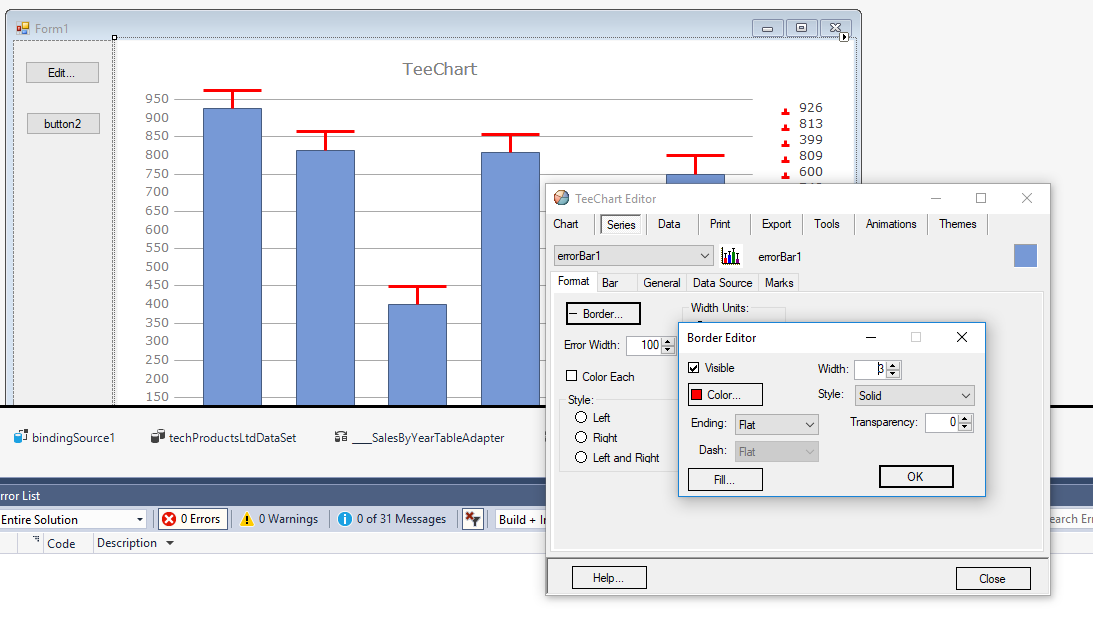

BTW Can I set _bar.ErrorPen.Color in designer (TeeChart Editor)? Didn't find that property on Series tab..
Okay.
Yes, this is possible using the 'Border' button:

bairog wrote:
Thu Dec 13, 2018 10:53 am
I didn't noticed that option because setting it doesn't change errorBar appearance at design time (only after rebuilding). Changing all other properties affect appearance at design time immediately. Thanks.
