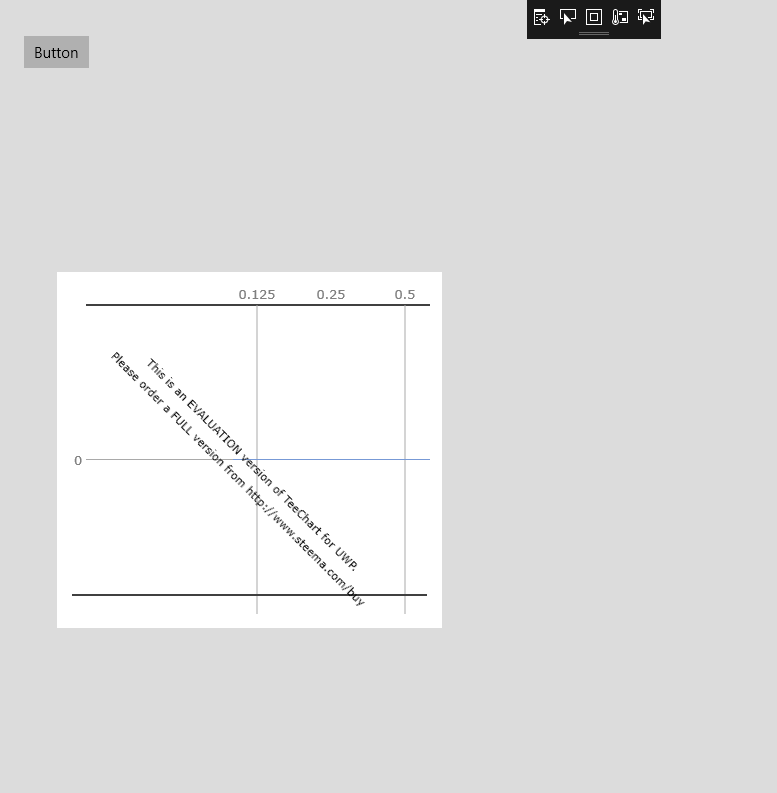

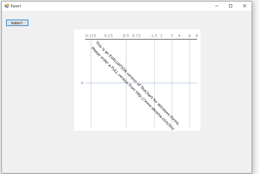

I attached the pictures with the results.
The result with Winforms meets my expectations.
In the UWP project the loagrithmic axis is stretched.
What did I miss?

Yes, when Chart.Aspect.GestureOptions != Aspect.Gestures.None the chart axes are 'streched' - if you set:
Chart.Aspect.GestureOptions = Aspect.Gestures.None;
then I think the images should look the same.

Hello Christopher,
Thank you very much! That worked for me!
