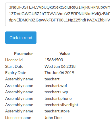

Try putting your license into the following page:
https://www.steema.com/linkIn/License_information_check
This is what I get with a dummy license:
Screenshot from 2019-08-09 09-25-08.png (32.92 KiB) Viewed 46210 times
This license will not work with Steema.TeeChart.NETCore.WinForm 4.2019.6.4 (note the license is valid by two days) because the 'Assembly name' of 'teechart.winform' is not listed. If your license does not have 'teechart.winform' listed it won't work either. Obtaining a new TeeChart.licenses file with 'teechart.winform' listed is easy to do by requesting one from sales@steema.com with your license details.
'teechart.winform' is not listed. I will contact sales@steema.com, thank you.
