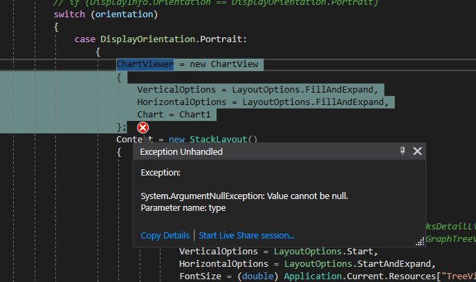

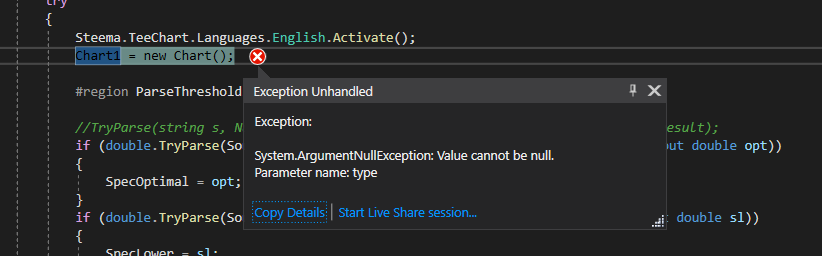

Below are the screenshots. Visual Studio 2019 (version 16.16) gives the exception shown, but still proceeds and renders the data without issue. all functionality works. but it gives this error. I've looked through the initVars() code that the Chart() function calls but don't see anything obvious. I don't see anything that could be an obvious cause for ChartView() either.
Also using Steema.TeeChart.NET.Xamarin.Forms version 4.2019.7.3.

does this happens on specific platform ?

Post by TLC » Thu Jul 11, 2019 2:57 pm
Only in Android. iOS doesn't occur.
