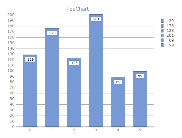

Hello!
How about:
        Bar _bar = new Bar();
            _tChart.Series.Add(_bar);
            _bar.FillSampleValues();
            _bar.Marks.TailStyle = MarksTail.None;
            _bar.MarksOnBar = true;
which gives me:

Post by Christopher » Wed Aug 05, 2020 8:13 am
if you're not entirely happy with the position at which 'MarksOnBar' leaves the SeriesMarks, you can turn it off and modify their position using ArrowLength, e.g.
            _bar.Marks.ArrowLength = -10;
            //_bar.MarksOnBar = true;

Ah, sorry, I must have misread your first message and missed your reference to Marks.ArrowLength! Either way, although the negative numbers may look a little strange, this is the most 'legal' way I can find to modify the position of SeriesMarks when Marks.AutoPosition is true.
