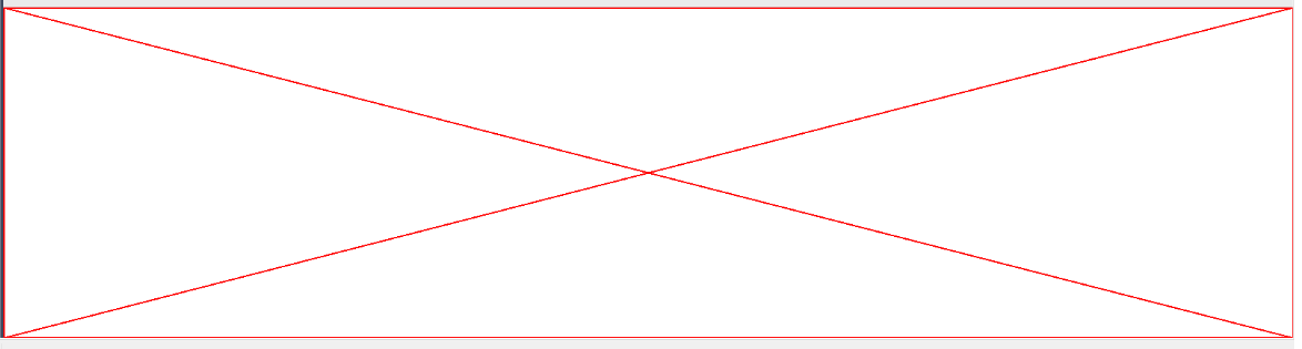

In my program, I need to dynamically add points to the line.
When I click the button, a line is created, and the method is called regularly to add points.
The line will be recreated when the button is clicked again.
The core code is as follows.

Occasionally the phenomenon shown in the figure below will appear. How can I prevent this from happening?

It's not an easy Recurring problem.it did not happen in subsequent runs.May not be the problem of adding lines.
But this is a hidden danger in my code.Do you have any other suggestions for this situation?
Re: The chart shows an error when adding lines
Post by Christopher » Thu Oct 01, 2020 6:25 am
Elite wrote:
Wed Sep 30, 2020 8:39 am
The 'hidden danger' may be multithreading - GDI+ is not thread-safe, which is why it is not recommended in future development as you can see at the bottom of this page. Other than this, and in the absence of being able to reproduce your issue here, I'm afraid I can't think of anything else.
