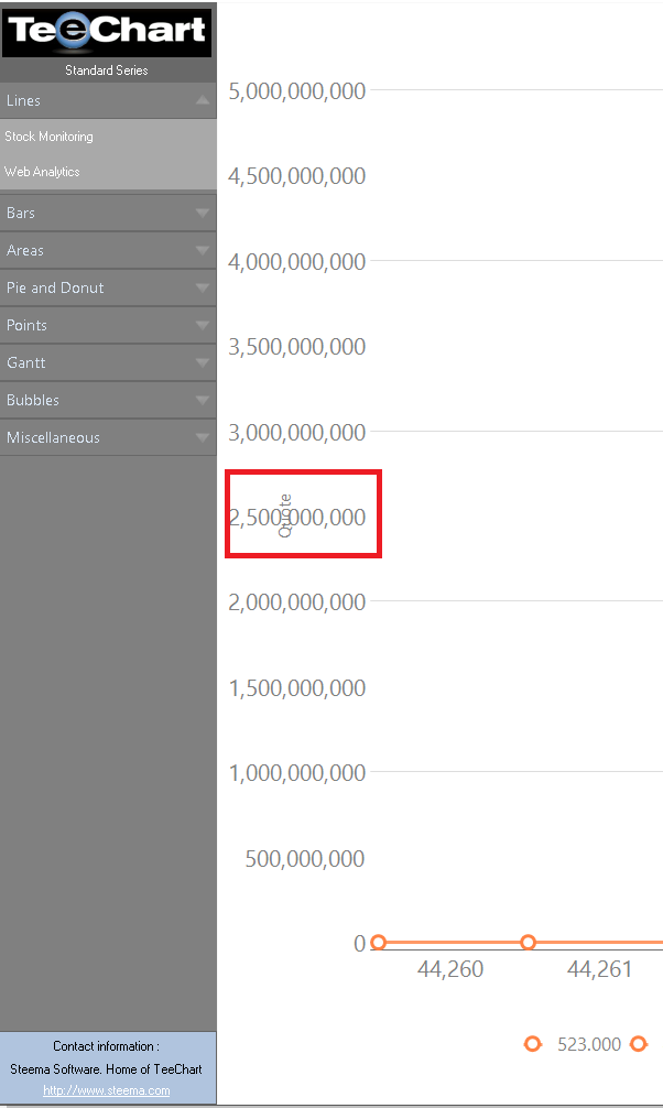

Y axis label title and values super imposed
Vineeth
Joined: Thu Feb 04, 2021 12:00 am
Post by Vineeth » Wed Mar 03, 2021 9:41 am

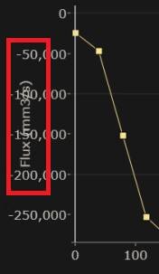

The Y- axis label title and values are overlapping. While loading initial time the position of label title and label values are correct. When I change the Y-axis unit or selecting another component , the position of label title is same, not getting relocated. Due to this issue my label title and values are getting superimposed. PFA for the issue details.
I am using Steema.TeeChart.WPF.TChart, TeeChart.WPF
Release Notes 12th May 2016
Build 4.1.2016.05120
I found the same issue in TeeChart example as well, while increasing the Left Axis maximum value to a large number
