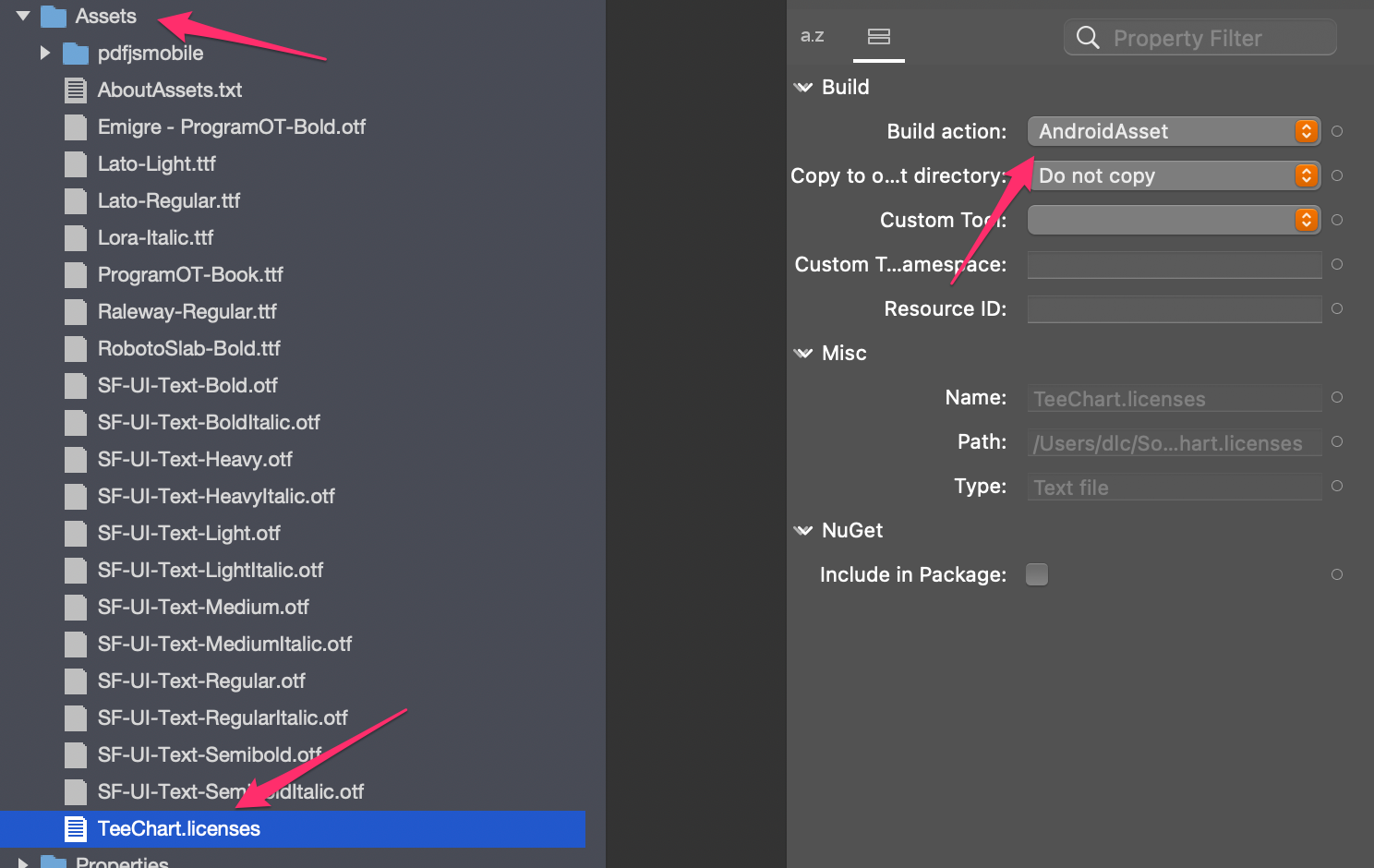

We are developing a Xamarin.Forms app on MacOS Monterey 12.3.1 (21E258). We are using the Steema Chart since a long time and never had troubles with it. We now encounter a problem with the licensing in the Android application.
Whatever we try, we can not remove the watermark in the release build. :(
We created the TeeChart.licenses file on a Windows 10 (10.0.19043.1645) and included it in de project as mentioned in the help (see attachment). This has always worked perfect for years, but since recently we run into this problem.
We are using this version of the nuget package Steema.TeeChart.NET.Xamarin.Forms => 4.2022.2.28
I hope someone has a solution for this, because we really need to push a new version of our apps.

A couple of weeks ago we released a version of our app with version 4.2021.10.20 of the package and then everything was ok. No watermark. When I deploy the same code again to my device I see the watermark.
The problem is not the package.
