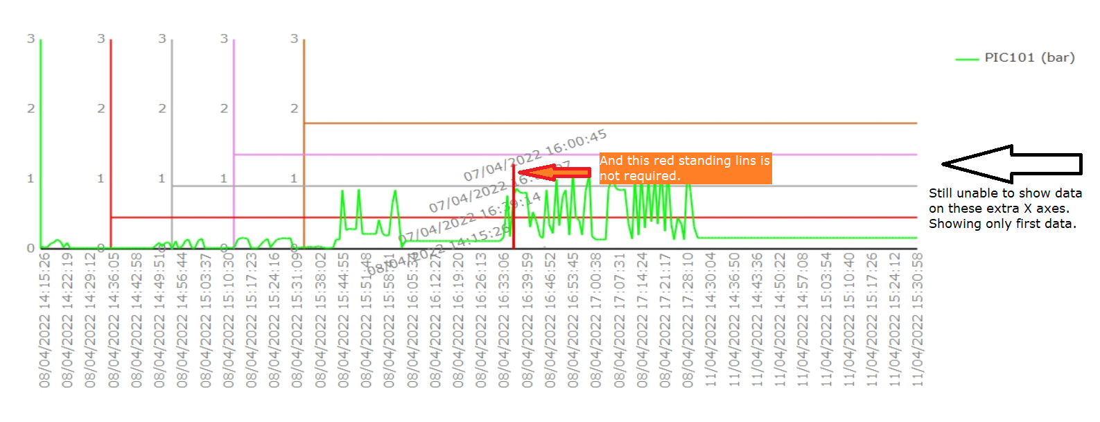

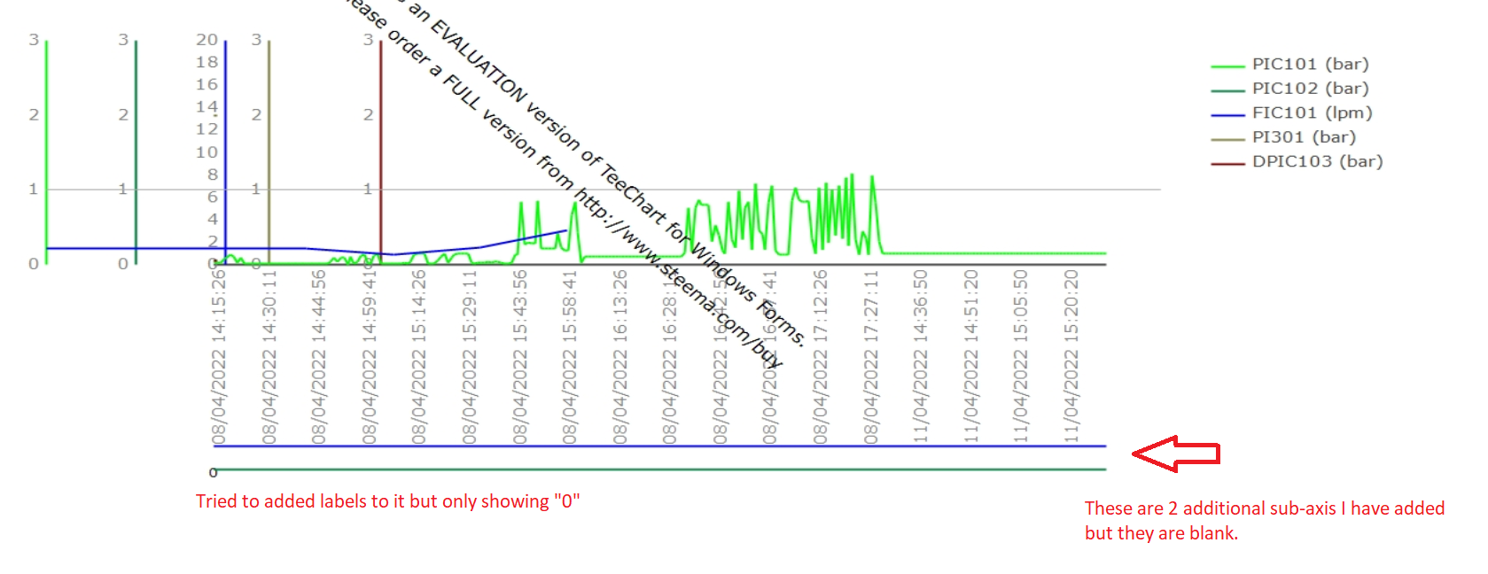

Greetings.
I got an assignment to display a chart which has a multiple X axes. It will show different data as pass it through a dataset. I tried to add sub-axes at bottom and but it is not showing attached labels on it. My first bottom (X) axis is perfect and I want to add more X axis to this chart. See pic.

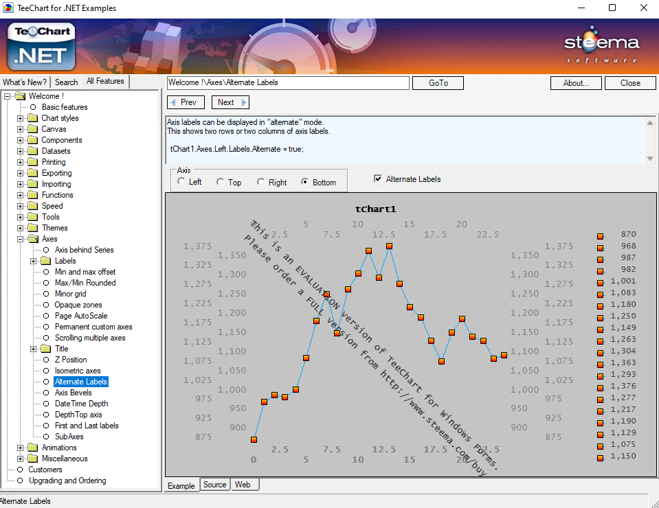

There are several questions related to 'multiple axes' and 'multiple custom' which may be of help; there is also the .NET Framework Windows Forms sample which has a couple of demos on custom axes:
Screenshot from 2022-05-20 14-35-49.png (184.94 KiB) Viewed 8473 times
Screenshot from 2022-05-20 14-36-02.png (225.4 KiB) Viewed 8473 times

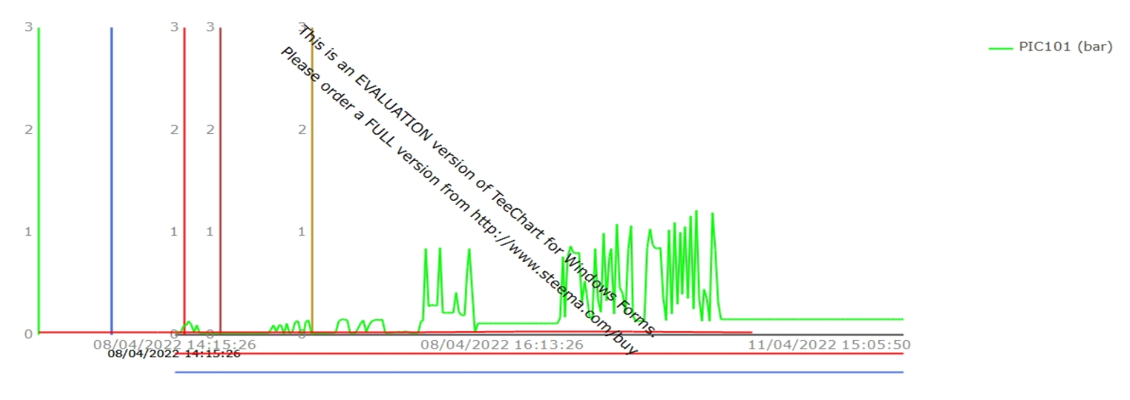

Thank you for your response. Tried example shared by you but not getting as per our requirement. pls see below image.
my code:
'line2
Y2 = (From p In dtMasterSales.Tables(1).AsEnumerable() Select p.Field(Of Single)(sTagColNm)).ToArray()
With line2
.Color = Drawing.Color.Red
.Title = "PIC101 (bar)"
.VertAxis = "Left"
.Add(dateIdx2, Y2)
.Labels = sLabels2
.XValues.DateTime = True
.Legend.Visible = False
.Visible = True
End With
Line2Min = 0
Line2Max = 3
line2.CustomVertAxis = AxsLine2
With AxsLine2
.AxisPen.Visible = True
.Increment = 1
.AxisPen.Color = line2.Color
.SetMinMax(Line2Min, Line2Max)
.Automatic = False
.PositionUnits = Steema.TeeChart.PositionUnits.Percent
.RelativePosition = 15
.Visible = True
.Grid.Visible = False
End With
tChart1.Axes.Custom.Add(AxsLine2)
tChart1(1).CustomVertAxis = AxsLine2
'------- Bottom axis code
Dim AxsLine4 As New Steema.TeeChart.Axis(True, False, tChart1.Chart)
With AxsLine4
.Increment = 0
.Automatic = False
.Visible = True
.StartPosition = AxsLine2.RelativePosition
.EndPosition = 100 '- AxsLine2.RelativePosition
.Labels.MultiLine = False
.Labels.Angle = 20
End With
tChart1.Axes.Custom.Add(AxsLine4)
tChart1(1).CustomHorizAxis = AxsLine4
line2.CustomHorizAxis = AxsLine4
line2.CustomHorizAxis.Visible = True
